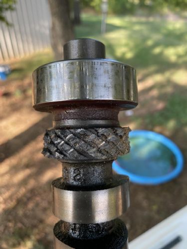

Well here it is........... Bucky sent me a picture of the camshaft that came in his project engine
It was a Reverse Rotation camshaft and somebody did their best to stuff a distributor for a normal rotation engine in that hole.
"I just ain't seen nuthin like that before" were the first words that came to mind.
Probably stuck it in as far as it would go and pushed a little harder and bumped the engine over at the same time. Probably repeated that move a handful of times too.

Amazing

These same type of people curse Fords while doing this abuse

Holy cow. I’m amazed it was able to kinda cut new teeth

Shocked

Y'all get all wound-up over a little scratch or 2?  That'll buff out.

I was worried all tha missing metal is in the oil galleries but I guess if it never started and ran the oil galleries may still be clean but I would at least run a magnet through the oil pan.   That is a First.  Someone was very determined to make it work.

Will be sure to change oil and run magnet through it

Good news everyone! I got it all buttoned up and it runs perfect, I appreciate everyones input on the situation. It still has a long way to go but i look forward to having it on the water next summer
