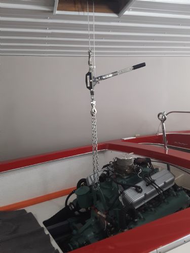

It's been awhile since I've posted.  Here's an update on the '65 Nautique:
Last summer the rebuilt 71C transmission with maybe 10 hours of use failed.  I was pulling into the boat lift, went into reverse to slow down, and the boat stalled.  Went to neutral, started the boat, and it lurched forward, almost going through the lift - that would have been bad!  Shifting into reverse stalled the boat again. After getting the boat safely on the lift I determined the transmission was stuck in forward.  Could have been so much worse as I think of the times where I have pulled up to a dock, counting on reverse to slow me down.  Well that was it for summer of 2022.
Fortunately, I had a spare 71C from one of the marine engines that I bought for parts.  It was an early unit mated to an early FE in unknown condition.  At least the fluid looked OK and so I thought it was worth giving a try.  At a minimum it would be a place-holder to attach the motor mounts to and hold up the rear of the motor while working on the failed transmission.  Degreased, and with a quick shot of paint to match the motor, it was ready to install.
The swap went well.  I used some lifting ears that came with one of the engines to suspend the rear of the motor.  Glad I installed studs in place of the lowest two bolts when the first transmission was installed to help guide the transmission into place.
After getting things bolted up, I went to the boat ramp.  Boat started, no leaks, so far so good.  Let it warm up, then checked forward and reverse.  Still no leaks and seemed to be going into gear properly.  Checked and added some fluid and took a cruise, everything worked fine.  I now have a couple of hours of cruising and all seems to be ok.
One of my winter projects will be tearing into the transmission that I pulled out to find out what happened and hopefully can fix it.
