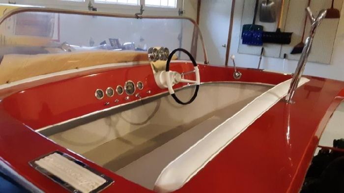

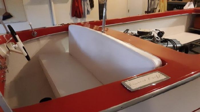

Hi All,
Thought I'd post an update on my '65 First Gen Nautique project.
First bit of news is that I found out my boat was built in 1965, not 1963 as the PO had told me. Art did a search and sent me a copy of the original build sheet.
Also, last year when I was down in Arizona, I met Bill Moore (1966 Ski Nautique in Diaries)and got to see his amazing original one owner boat. Turns out, our serial numbers are within 2 digits. Every piece of plywood in his boat is original and in exceptional condition, so I was able to take photos and measurements to create the same pieces for my boat. I should mention that Steve Kutsch has also been a big help sending me pic's of his Dad's 64 SN.
Progress continues to be very slow but I'm still hoping to have it ready to take to GL this summer. I've been following Craig's 67 SN Resto/Mod thread with great interest. for my boat, the floor strapping is as original, floating at the ends but resting on a wood strip that might have been added (or possibly just replaced?) by the PO. The 1/2" plywood floor sections will be painted white and wrapped in textured vinyl (white with black specs) and screwed in place.
I also used the floor vinyl to cover the inside of the hull since the condition of this surface was very poor due to sloppy repairs by the PO. It's not exactly original, but I think it has a nice period correct look to it.
Gauges are all original SW except the tach. Unfortunately, an original Ongaro tach purchased from Zach was lost by FedEx. I was able to find a vintage Sun unit on ebay that closely matches the style of the other gauges.
The 390 FE is still at the machine shop.
-Phil

Posted By: Mojo
Date Posted: February-25-2015 at 1:40pm
Phil,
Boat looks amazing !! We definately want to see that beauty in GL this summer. Keep pounding away. Doesn't look like you're to far off at all !! Funny how manufacturing dates get screwed up over time on peoples paperwork.. Anyway, you have a newer boat LOL..
Moj'
05' SV211 TE
73' Martinique
had:96' SNOB
had:76' Nautique
had 77 Tique
Posted By: phatsat67
Date Posted: February-25-2015 at 1:46pm
Ditto Phil! That thing is stellar. Especially like the red.
Posted By: 8122pbrainard
Date Posted: February-25-2015 at 3:52pm
Keep up the great work Phil.

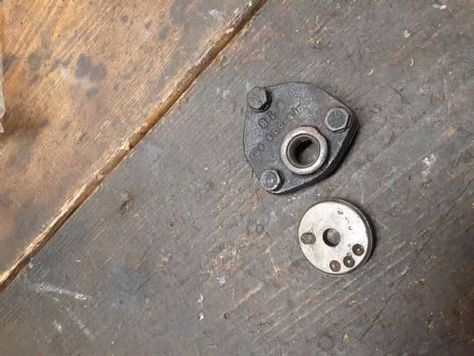

Hey all, progress on the 65 has been slow but things are finally coming together. Just finished adding the boot stripe (painted) and new rub rail.
I followed Pete's advice to fill the old holes with epoxy and drill new ones located with a Vix bit which worked well.
The rudder, strut, prop, and shaft are also back, alignment looks good. Hopefully the motor will be dropped in before the end of the month.
-Phil

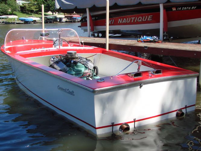

Posted By: 70CC
Date Posted: November-25-2018 at 11:00pm

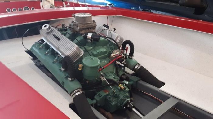

Finally got the motor installed!

Looking great!. Nice color on the engine. How did you match and what kind of paint did you use?
Posted By: 70CC
Date Posted: November-26-2018 at 11:32am
Duplicolor Engine Enamel Detroit Diesel Alpine Green, It's a perfect match to the original Interceptor color.
Pete - Your video on shaft alignment has been really helpful. My engine builder made some aluminum shims to replace the original wooden ones.at the front motor mounts.. Alignment is pretty close, Next step is to re-mount the strut with 4200 and do my final adjustments.
I'll have to do some modification at the bulkhead just ahead of the motor as there is not enough clearance to R&R the water pump without raising the motor off the stringers.
Posted By: SNobsessed
Date Posted: November-26-2018 at 11:58am
An iconic boat for sure!
I'd notch that bulkhead for WP service clearance & make a doubler plate to reinforce it. Resin coat all the screw holes & it won't be a problem in your lifetime.
Date Posted: November-26-2018 at 12:59pm
Phil,
I don't mean to pick on your choice of color but the Alpine Green is close but not the same. I used it on my Universal Flexifour and comparing it to my Y block, it's a touch too green. Reid got it dead on but if I remember correctly he had the color matched. Internet color rendering can be off but here's a picture.
Also, remember engine/shaft/strut alignment starts at the strut. Get the strut mounted so the shaft is close to center in the log and then move forward. Nice idea on the aluminum wedges. Lots of the older engines used cast iron wedges but they are becoming very difficult to find.

Posted By: 70CC
Date Posted: November-26-2018 at 6:37pm
I'll take Pete's comments as nothing but constructive.
If I have any parts with the original paint on them, I'll bring them to the next GL reunion!
Chris, I had a similar idea on a removable bulkhead reinforcement, but I might incorporate that into an aluminum plate that I can mount a fuel filter to.
Any thoughts on adding a shut-off valve between the gas tank and fuel filter? All of that was missing on my boat, plus I want to improve the safety wherever possible.

Making a little progress on getting the 65 back together. I'm using the original oil/trans cooler and remote oil filter. Hooked up the cooler to pump and filled with water to check for leaks before hooking up the new cooling lines.
Here's a pic of the oil lines exiting the block, routing to the filter (outside of element), then inside port of filter routes to the front section of the cooler, then back to the block.
Adapter plate also shown to illustrate that the "lower" fitting is the output of the oil pump.
Next, I'll connect the transmission lines. Getting to the oil/trans cooler fittings would be tough if the exhaust manifold was in place!

Posted By: 70CC
Date Posted: April-16-2020 at 12:57pm
Thanks guys. Here's one more after the trans cooling lines were installed.

Posted By: Riley
Date Posted: April-16-2020 at 1:15pm
Looking great, Phil. How about some full engine shots? I'd test that oil system. I know of 2 different people that hooked it up wrong on FEs and damaged the engine.
Posted By: 70CC
Date Posted: April-16-2020 at 6:09pm
Let me get a few more things bolted on...
I remember we discussed the oil system in the P.M. If you look at the two earlier pictures of the adapter and the hose routing, does that look correct to you? I should have the output of the pump (lower fitting on the adapter) going to the outside of the filter.
Posted By: Riley
Date Posted: April-16-2020 at 7:47pm
Phil, I can't tell by the photo. I do have in my notes that when looking at the block, oil goes returns to the engine on the left and oil comes out and goes to filter on right.

Posted By: 70CC
Date Posted: April-18-2020 at 4:49pm
No question I want to get the oil lines hooked up right!
I got the 65 as a basket case without an engine so I don't really have a good baseline. I did buy a complete motor out of a 65 Century and marked the hoses with tape when I disassembled it, but oil soaked through the tape and made the markings unreadable.
Pretty sure I have it right, and the hoses fit properly, but appreciate any comments.

Turning my attention to the stern...
There were no bilge vents or blower originally installed on the boat (despite the 64 Brochure stating two bilge vents to be standard equipment.).   I picked up a nice used pair of chrome cowl vents at a swap meet and ordered an inline 3" blower from Nautique Parts.
I've been dragging my feet cutting the 3 inch holes in the rear deck but finally mustered the courage yesterday. I drilled a pilot hole first, then ran the hole saw backward to score through the gelcoat, then finished the hole in the normal direction. Not sure this was necessary, but I did not experience any chipping of the gelcoat using this technique.
With the vents and clearance bar installed, it's time to hook up the exhaust hoses and then install the gas tank.
Posted By: Gary S
Date Posted: June-09-2020 at 6:20pm
Looking great Phil. Don't leave any sharp holes in the gel like this- I I   do this instead \   /.

Posted By: 70CC
Date Posted: June-10-2020 at 11:59am
More drilling...

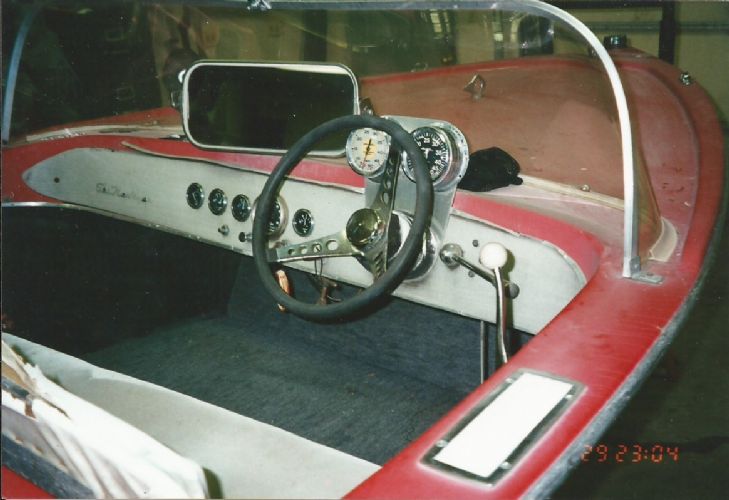

Posted By: 70CC
Date Posted: June-10-2020 at 12:32pm
Steve, I don't believe my boat had any graphics, just a boot stripe. Good time to post some "before" photos that the P.O. gave me before he dismantled the boat.
The non-original 427 pictured was retained by the P.O. to go in a street rod. He basically bought the boat to get the motor, was going to fix up the boat, then lost interest...
The grey panel on the dash is a piece of weathered wood veneer that someone added a long time ago. The 70's era dash mounted ski mirror is for sale.

Some updated pics of the helm and new front seat - my boat likely left the factory with throwable cushions for the bottom and a snap in back cushion but I had the new upholstery attached to the plywood.   The last pic was taken by the PO prior to disassembly.
The dual speedo mounting plate is original to the boat and would have had aqua-meter gauges mounted to it (one 45 MPH, the other 55 MPH.  Looking at the base, one of them was surface mount, the other flush mount)  - when I got the boat it had, 5" 50 MPH airguides which hung over the edges of the plate -  It now has two 4" 45 MPH Airguides.  You can barely see the hand shift next to the steering wheel and the Morse hand throttle (a $29.95 option)
Posted By: 67 ski nat
Date Posted: September-27-2020 at 5:06pm
Beautiful thank you. I needed that

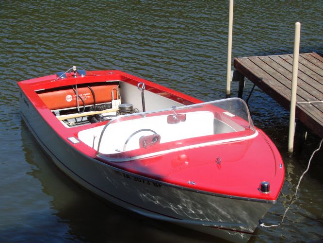

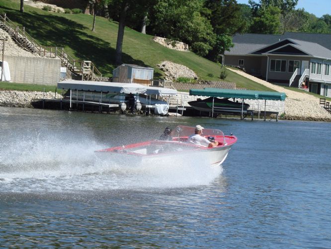

Date Posted: August-16-2021 at 10:04pm
At long last... the '65 is in the water and running again! (after at least 30 years, 11 of those in my possession)
Initial start on a garden hose went well until it started to rain, Next I dipped the boat in the Cedar River on the trailer to finish breaking in the cam, test the complete raw water system and transmission shifting.  Found my thermostat housing was leaking, fixed that, then trailered to Lake Delhi for the shake down cruise.
Docked next to the 97:
Running down river about 25 MPH
Thanks to Keith and everyone on CCFan that has helped with this project and provided moral support along the way, especially Art who found the original bill of sale and helped with the missing puzzle pieces.

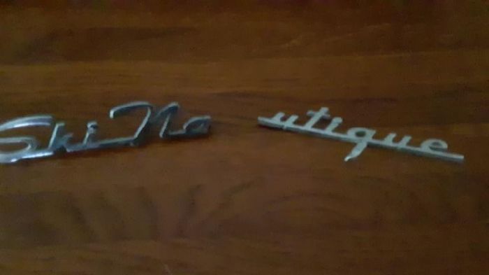

I'm looking for a few items to finish off this project:
The Ski Nautique script that goes on dash is broken in two pieces.  I believe its the same emblem used on the Gen 2 boats, and maybe even the 2001's?

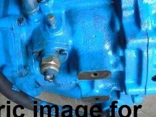

My 71C does not have a neutral safety switch.  If anyone has a junk Velvet Drive laying around, I'm interested in the switch, the mounting plate, and the cam that actuates the switch (like the one shown here).
Send me pm if you have either of these.  Thanks!
Date Posted: August-20-2021 at 10:19am
I believe the neutral switch is still available new. I found one on eBay, bought one as a spare
Date Posted: August-20-2021 at 10:23am
Try. 1000-640-004. Velvet neutral switch

Like he mentioned he needs the cover/mounting plate and the cam too, not just a switch  Wink
Posted By: KENO
Date Posted: August-20-2021 at 2:33pm
Phil
I dug through my "pile of parts that might come in handy for somebody one day" and came up with what's in the picture.
It's the cam and the plate you need.
I found a dead switch, but that won't do you any good.
This plate takes the newer NSS that has a 7/8 hex head. The PCM part number is R153011 for the switch. The part number listed and linked earlier will fit. There's a wide variety of prices when you get looking.
It's cheaper than the old bigger switch too Wink
Send me a PM with your address and they'll be on the way to Iowa for a worthy boat.
We'll call it a donation to your project

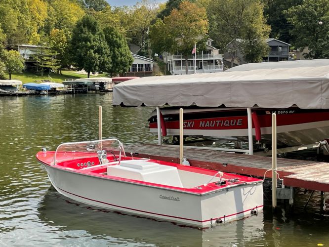

Date Posted: October-03-2021 at 9:18pm
Velvet drive updated with neutral safety switch - thanks again to Ken.  Motor box and rear hatch cover added.

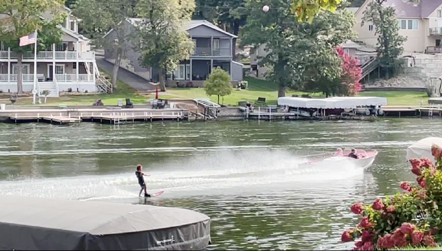

Posted By: 70CC
Date Posted: October-03-2021 at 9:30pm
Pulling its first skier in about 30 years...
