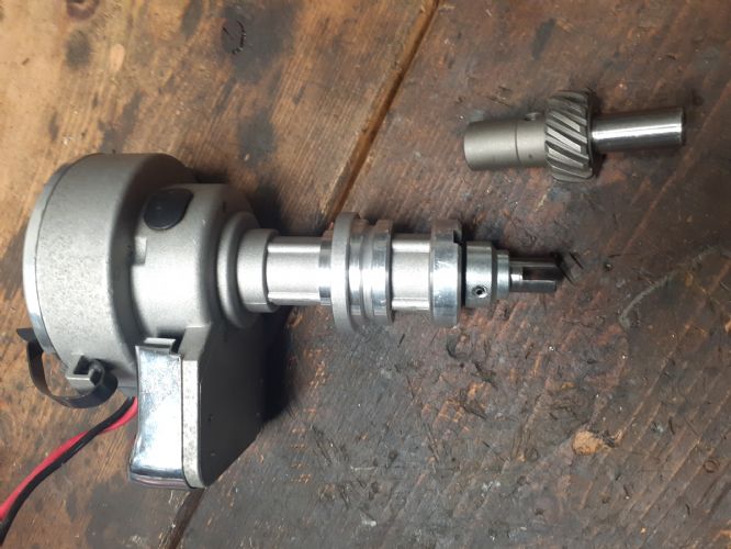

Well here it is........... Bucky sent me a picture of the camshaft that came in his project engine
It was a Reverse Rotation camshaft and somebody did their best to stuff a distributor for a normal rotation engine in that hole.
"I just ain't seen nuthin like that before" were the first words that came to mind.
Probably stuck it in as far as it would go and pushed a little harder and bumped the engine over at the same time. Probably repeated that move a handful of times too.

Nice work boys fixing Bucky up.  When we installed the cheap HEI type distributor in my brothers Supra, 351W reverse rotation we removed and swapped the cam gears from the old dist to the new dist.
So Mark, I just have to ask, since you seem to talk about safety a lot, why is it that you have talked numerous times about you, your brother and a friend all having non USCG distributors in your various boats over the years?
They must have had a reason to require the manufacturers to have ignition protected stuff Wink
And here you are telling Bucky he can swap gears to put one in his boat.
In his case it would be a little more involved than a gear swap. The Chinese distributor in his earlier photo has a 2 piece slip fit shaft and the gear is a bit different than his Prestolite gear..
The picture is the same brand distributor that I took out of a friends boat a few years ago because it wasn't marine rated.
It worked good, but well you know a few stray gas fumes, a sparking distributor that's not ignition protected and it's not a pretty outcome.
I might be a little curious also as to what year and model of Supra  came with a RH rotating engine?
Early years they had LH engines and props, then when the PCM 40A came out, they had LH engines and RH props and then they went to LH engines and LH props again when they changed engine suppliers
