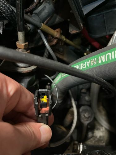

No guarantees, none at all, well maybe a slight one, but for about 9 bucks, I'd give the connector in the link below a shot. It may look a little different but it fits a bunch of pumps that cross reference to your original that should look like the one in the picture. If you get one, just promise to post here whether it works or not for your 95

Funny you should that because I already had my new harbor freight fuel pressure gage in hand when I found the broken connector! On another note, any idea where I can order a new connector? It looks to be part of a harness so not readily available on the usual parts sites I shop on.

finally took the time to do what i should have done earlier: looked over the electrical connections to the fuel pumps. i found a broken clip on the connector to the HPP that allowed it to loosen and separate. I taped it back in place and all is good! I wish they were all this easy....
