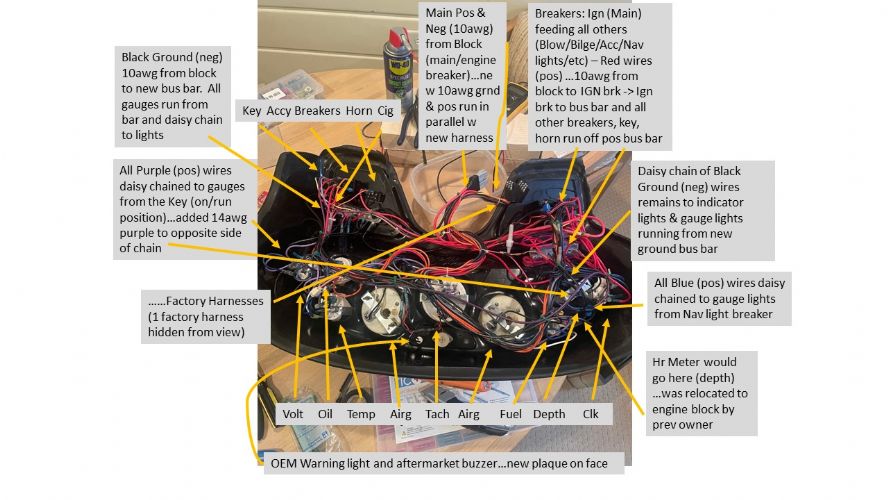

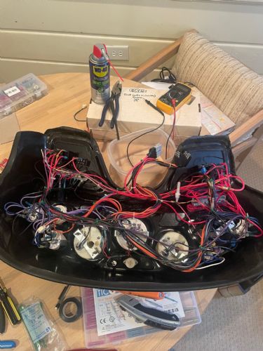

Starting this wiring project:
Plan is to get rid of much of the daisy chain:
The blue scotch locks are for the depth finder. Leaving as is. Questions:

I would be careful on your nomenclature first of all- purple isn’t just “positive”, it’s keyed power. Anything that runs only when the key is on will be affected by this circuit. I would try not to daisy chain anything that draws a meaningful amount of power- gauges are fine but anything breakered/switched individually probably should be given a clean power source.
The only other bit I’ll mention is that I’d be careful not to bypass any factory breaker/fuse protection, and to make sure you’re adequately protecting your boat with breakers/fuses and wiring size choices. The methodology you should be using to size wiring and breakers is to make the wire an adequate size to feed the current draw of the component it’s feeding, and then breaker a bit below the current handling capability of the wire. |

Thanks for the initial comments...I went back and edited a bit in case someone looked at it in the future.
I plan to use the existing breakers/switches and will be using wire that is the same size or one gauge larger.

Plan sounds good to me Where's the other end of the blue wire go to? They had a buzzer along with the light Cleaning the female connectors, I usually use small drill bits or taps that are just a little smaller than the hole so I can do a little scraping of the junk (Along with your favorite electrical parts cleaner) |

Ken - that blue wire is daisy chain (pos) for the gauge lights. It comes from the Nav Light breaker/switch. I’m betting the orange is for the curtesy lights. Prev owner must have removed oem alarm/buzzer. Think I’ll leave the after market. I’ll have to buy some contact cleaner. |

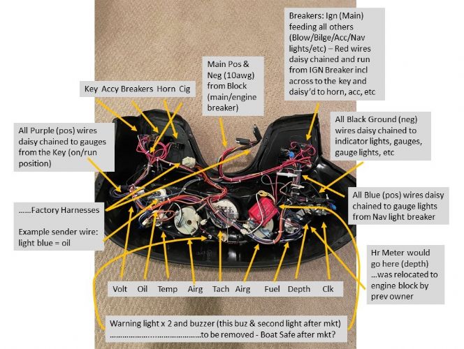

I don't see any way to have a pizza and beer at that table, seems like a significant problem to me. On wire size, I do think at times there's a tendency to oversize wires to correct the OEM dash deficiencies. As I see it the problem is all the daisy chaining, which you are of course fixing, not that the wire used was all that undersized. Better ground is always a good idea and it can never hurt to upsize that wire.

This may not be perfect but I would have liked to have been able to look at a pic like this. (Red wires are (pos) in the pic…I should have marked). Will post an updated pic once I finish adding bus bars and removing some of the daisy chain. Boat safe box to be removed. Will leave original light and aftermarket buzzer. Will hide or remove aftermarket warning light.
Re: wire size comment above: I am adding additional 10awg positive and negative to run in parallel with original. Any new wiring I did to remove daisy chain is in 14awg instead of the factory 16awg. |

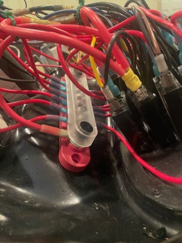

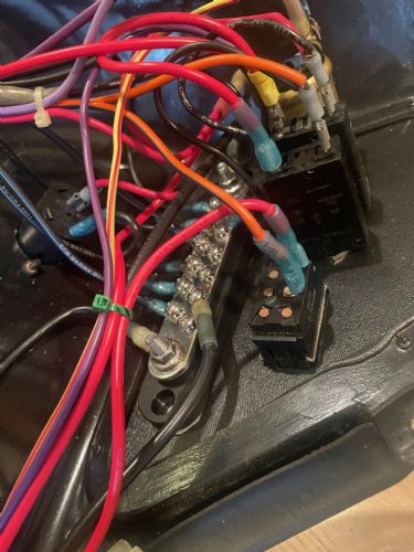

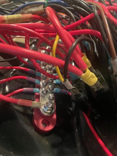

Finished the dash pod. Next is to run the new 10awg wires from the block and reinstall dash pod. My wires are a bit messy around the breakers but I think it turned out well...hard to clean it up with the daisy chain of indicator lights running everywhere. I also could have used some yellow heat shrink female spade terminals. I needed ~4. Oh well, the regular ones match from factory. Double sided tape on the back of the bus bars
New pod: Bus Bar close ups Dash Pod with notes: |

Holy Moly, and I thought installing 2000 wood plugs in my Collegian was tedious. Nice work David

Wired to engine and dash reinstalled. Horn is strong! Happy about that. Didn’t have the key with me so more testing to come but seemed that everything worked that runs off ign breaker.
