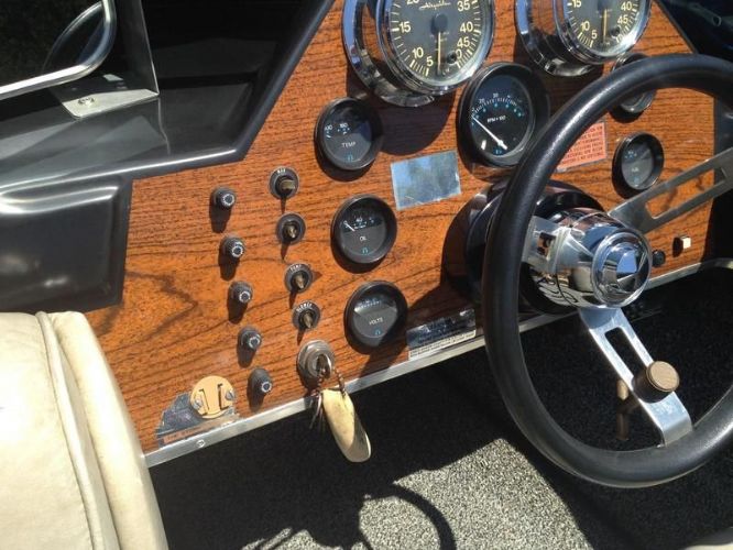

Here's a picture of an 83 or 84 (basically the same those two years) from somewhere here on CCF
Looks pretty normal except for that thing to the left of the ignition fuse
Gauges on the left are temp, oil and volts from top to bottom
Gauges on the right are hours and fuel top to bottom
Bilge drain plug in a good storage spot on the steering wheel  Wink
