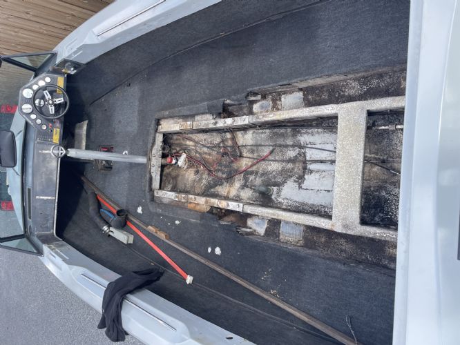

Removed most of the fiberglass flooring plus all the foam under the front deck over the weekend. I don't think i'm going to reinstall the hump under the front deck, just going to run the flooring through flat. i've got some mahogany laying around from an old bleacher tear out we did, I can make a foot rest from that and attach it to the floor. Don't see any real need for that hump full of foam. Boat has been out of the water and under cover for 2 months but bottom 2" of foam was still soaked.

gun-driver ![]() Grand Poobah ![]() Joined: July-18-2008 Location: Pittsburgh, Pa Status: Offline Points: 4129 |
Now you should be able to get a big pipe wrench on the bottom of the pylon.
Since I already did a complete gut and stringer job on my ‘85 I would suggest only tearing one side out at a time. It’s a whole lot easier getting your heights and measurements when you can mirror the other original side. JMHO

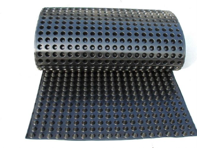

uk1979 ![]() Platinum Member ![]() Joined: June-13-2007 Location: United Kingdom Status: Offline Points: 1426 |
I have played around with foam in the hull... I went with lining the area with DPC (Damp Proof Course Polythene) leaving plenty
running over the sides to fold over the top to seal up once set. After setting and sealing you can the lift the foam-covered
blocks and any puckering of the DPC can be shrunk using a hot air gun, I went
with a second covering of DPC and shrunk it over the first with the hot air gun
and the blocks still fit back in the hull, that up to you. The older hulls do let water through only by a very small
amount, but over time/years it’s a problem, once you have finished the stringer
work clean back the hull of all old coatings and tank it all in epoxy resin 2 coats the second before the
first is fully dry. Moisture will always be in the hull just by temp changes its
just keeping as low as you can. Thanks for saving an old SN and keep the pictures coming good
luck. roger. |

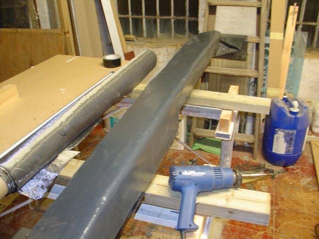

Enjoying this thread. Keep up the good work! Think about using thickened epoxy to bed the stringers instead of 3M caulk.

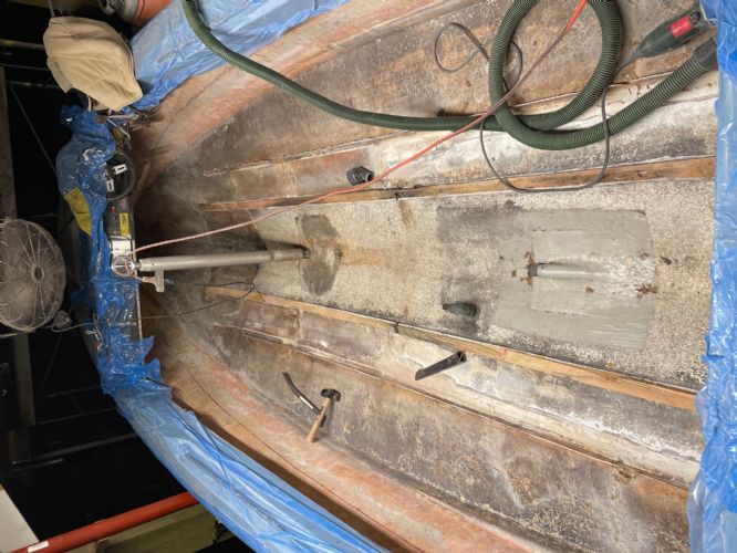

andrewmarani ![]() Senior Member ![]() Joined: May-31-2005 Location: Baltimore, MD Status: Offline Points: 256 |
Got the last bit of main stringers out with a router and a half inch bit, used a guide to keep the bit in the middle of the stringer and cut down ALMOST to the hull (was very careful about that!). Then I was able to split one size of the stringer off in small pieces and pop the other side out in large lengths, so not as difficult or time consuming as I expected.

GottaSki ![]() Grand Poobah ![]() Joined: April-21-2005 Location: NE CT Status: Offline Points: 3372 |
For the floor you could consider using the lighter density 3/4 coosa as a core and just epoxy some mat to both sides. it gets very rigid once the glass is there on the outside to take the brunt of the compressive and tensile forces.
and still wouldn't foam-fill it. neither my supreme nor response are foam filled, and they are the quietest boats in the local fleet of my hommes
