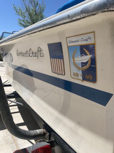

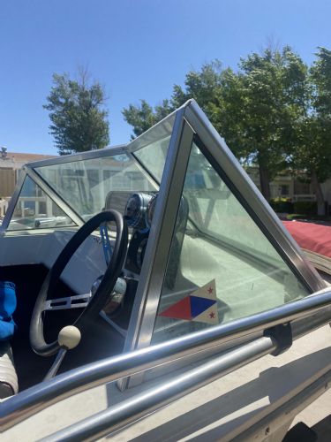

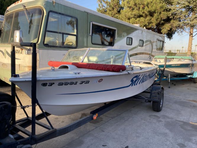

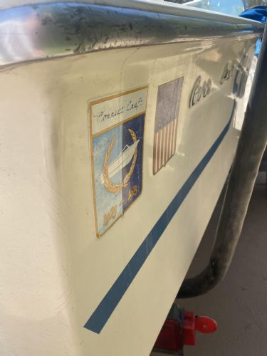

Still filthy in these pics.  More to come.  Figured out how to load so they are oriented properly.
expect it to be very cool when finished.  These are all of the pics I have at the moment.  I will take more and send as I make progress.  At least now she has had a bath, carpet cleaned, observers seat turned around, blah, blah, blah.

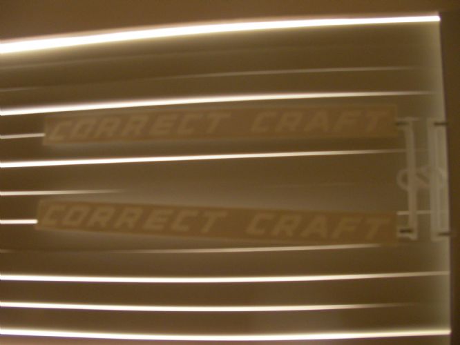

I have 2 of these for the transom, they are a decal stencil, stick it on, paint then peel. I also have the dimensions and font for the stripes  and competition ski boat which are under correct craft for the transom.
I'm looking to have both correct craft, the stripes and competition ski boat made from mylar so they can be re usable.
a national tow boat with stripes stencil would be nice to have as well.
Very happy to donate 1 of these decal stencils and the pdf of the stripes and competition ski boat to a stencil maker who can make what we're both after.
By the way, i traded a member for the decal stencils and i think what's a pdf of the stripes and competition ski boat, they are 100 percent exact in size and the exact font, hopefully the member power of correctcraftfan can find a stencil maker ( i've had no luck, primarily because the stencil would be something like 53 or 54 inches long, have to load a micro sd to get that exact number) Someone can make  them.
Nice boat by the way, get more pics up
Post Options Post Options   Thanks (0) Thanks(0)   Quote fanofccfan Quote  Post ReplyReply Direct Link To This Post Posted: May-03-2022 at 10:24pm
Sweet boat. Looking forward to seeing the other photos!

Very nice boat indeed!

Originally posted by WetSet3 WetSet3 wrote:
There's something that's just "not quite right" about those Correct Craft decals at the back Wink

Garzon studio has those decals to correct it. They are good quality and the right size.
And Stan has the side emblems. Looks like starboard is missing some.

I already spoke with Stan.  I should have the Emblems any day and I already have the decals from Garzon.  I love the assistance!
I really would like to Get another period correct speedo, and re-do the faces so I have a matched set.  or find another black one to match as a minimum.  I am sure one or two will pop up

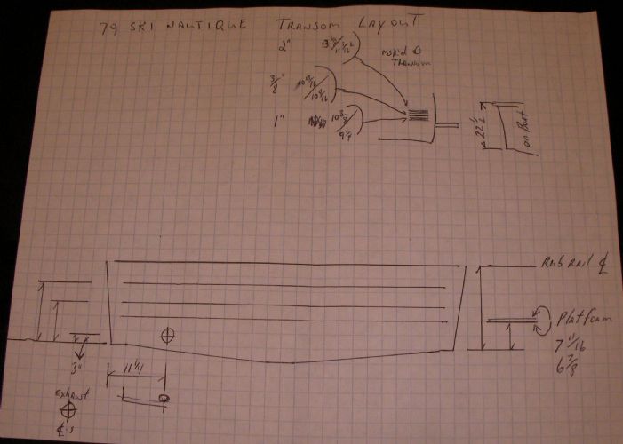

Heres what i got on paint and transom layout.
On the sides, the measurement is 9 1/4 inches from hull to bottom of stripe at the transom.(at least on mine)
You see i don't have the elevations for the transom but that was before another member sent the transom pdf.
Someon has this era hull and a tape measure, maybe they could post elevation of and spacing between lines 1&2 on the transom,
Same thing with the spacing on a 2 stripe boat
(betcha they had some sort of template and the spacing is the same between the top and bottom stripes on the 2 and 3 stripe boats with the middle shadow stripe being an option or something, that would make that spacing approx 3/4 inch)

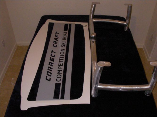

Mailman brought my stencil today, good quality, great customer service, fast turnaround.  78 bucks stencilsonline.

Should be longer stripes on either side of national tow boat.
Reusable to about 20 times i think they said about the 10 mil mylar.
Paint your boat, epoxy the garage floor, paint it on the man cave walls, paint your neighbors van, paint the middle of an intersection, slap it up on a bridge overpass, on the glass doors of city hall, dumpsters, trains, semi trucks,see where i'm going with this ?

Download this picture and email it to them, that's how they made mine.
In your email to them include how you want it to read national tow boat in 2 inch capital letters.
I'm not an e-mailer gadgeteer phone up my butt while walking and driving type,
i called them, customer service was excellent. Proof accept and paypal was done online thru gmail.
Sending a pm out to ya now.

So, did you find the Airguides you need ?
I also have a '74.    I might consider selling my original pair of Airguides. They both have new white faceplates.
The decal that Keno mentioned "1925-1975"   ???
