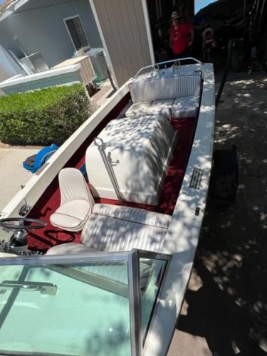

I recently re-purchased the first Ski Nautique I ever owned. It is a 1974. Was Ralph Maloons personal promo in 74 and original owner told me way back when the boat pulled the nationals in 1974. The guy I sold it to kept it in the garage and put 46 hours on it in 32 years. It now has 466 original hours on it. It was a crazy purchase, as I need another boat like I need a hole in the head, but it was always a great runner. Softer wakes than any of that era Nautiques I ever skied behind and a 255 hp ‘Palmer’engine, marinized by Thermo Electron, which is Crusader. The boat would bury the speedos over 50 with ease. It was the first boat I ran 35’ off behind and I always felt is was a great, unique old Nautique.
So now I want to make it a collectors item at my Ski Lake. Originally, red lettering with Royal Blue accent stripe. ‘Correct Craft National Tow Boat’ on the transom. The guy stripped the transom, painted the red to blue and got rid of the arrow and accent stripe. I am going to go back to original and need to know the following:
- color of original red (I know rust oleum professional)
- The spacing difference between Ski Nautique and the accent stripe
- the thickness of the accent stripe. And if it tapers, what is the thickness at the bow vs stern.
- height of ‘National Tow Boat’ it was on one line across the transom
- I understand stencils are no longer available for the sides, but wondering if they, or a graphic is available for ‘Correct Craft’ on the transom. It was in all caps, with all letters the same size.

Posted By: WetSet3
Date Posted: May-03-2022 at 6:18pm
Still filthy in these pics.  More to come.  Figured out how to load so they are oriented properly.
expect it to be very cool when finished.  These are all of the pics I have at the moment.  I will take more and send as I make progress.  At least now she has had a bath, carpet cleaned, observers seat turned around, blah, blah, blah.
