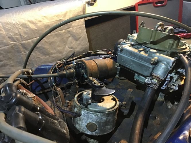

Well, Reed sent me a couple of pictures and a short video of the engine cranking over.
Sounds like an engine that has no spark or no gas. Told him to check for spark and try priming it with a little shot of gas down the carburetor being careful to watch for a backfire out the carburetor. Like he said earlier and the video also showed, it turns over with the shifter in forward completing the circuit through the Neutral safety switch, the relay/solenoid isn't his issue The distributor has a Prestolite electronic module in the original Prestolite clip down cap distributor. |

Coil and distributor look to be in poor condition…from the outside anyway. Love the fuel line.
I would trust KENO’s nose and troubleshoot spark and fuel first. 2-3 tablespoons of gasoline down the old carby has worked well for me. Be sure to replace the spark arrestor first. I’m putting my money on spark problems. JQ

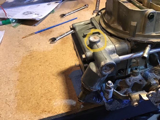

Is this the needle/seat?
79 Tique
Grand Poobah Joined: June-06-2004 Location: United States Status: Offline Points: 10604 |

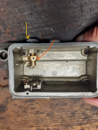

Here's a picture of a Holley inlet seat partially screwed in (orange arrow) The yellow arrow is pointing at the plug you have circled in your picture. You don't want to mess with that plug unless it has an external leak. You access the internally adjustable needle and seat by taking the float bowl off and removing the plastic baffle, the float and it's spring |

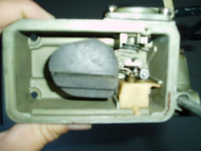

Here's a slightly fuzzy picture of what it looks like if you take the bowl off and hold it upside down The white baffle slides out to access the needle and seat after the float and spring are removed. |
