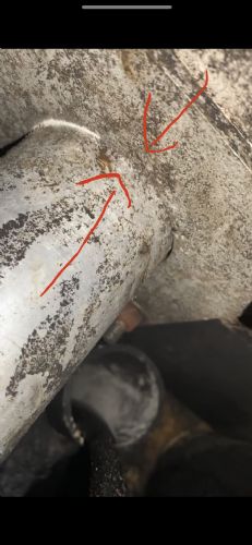

Hi, I picked up a 77 ski tique this year and I've noticed the pylon is a little loose. If I hit it with my palm it will vibrate, so it's not too loose. If I tug on it back and forth, side to side with all my mite, it might move maybe 1/8" at the top. I looked under the floor and I can see movement of the pylon itself, but the bottom square floor mounting plate seems solid. The pylon has play within the square 4 bolt plate under the floor. The top square mounting plate is still carpeted so I can't see what's going on there. Before I go ripping up carpet, I was wondering how the pylon top mounting plate is fastened to the pylon. Is it welded, press fit, just slides ver the pylon? (Then what prevents the pylon from being picked straight up?). The glassed in socket on the hull seems fine and there doesn't appear to have any retention cross fastener there.
My two guesses right now are either the pylon or mounting plates have worn down and allowing play, or the floor is spongy and allowing the top plate to teeter a little, but not the bottom plate. Again, the bottom plate appears solid and doesn't move. The movement is the pylon inside the hole in the bottom plate.
Here is a photo from under the floor showing the gap between the pylon and hole in the bottom square mounting plate.

Dave,
The bottom of the pylon fits over a cup that's glassed into the bilge. It's carbon steel and they have a tendency to rust so the pylon may not fit tight anymore. You also may have some rot going on in the cross member between the stringers where the pylon plate bolts.

Thanks Pete. I thought the pin was part of the pylon and went into the socket on the floor. What you said makes more sense and explains the play. If I can't find any rot in the cross member, do you think I could just leave it alone then? I don't mind the play so long as the pylon is reasonably secure (for an older boat).
Also, what keeps the pylon from pulling straight up and out (removal). Is there a set screw near the bottom of the pylon to secure it to the pin in the hull?

Post Options Post Options   Thanks (0) Thanks(0)   Quote 8122pbrainard Quote  Post ReplyReply Direct Link To This Post Posted: August-24-2021 at 10:01am
Dave,
Leave it alone if you don't find a problem with the cross member. That era of pylons always had some play in them. You may or may not find anything at the bottom Some had a bolt through the pin and some didn't.
Post Options Post Options   Thanks (0) Thanks(0)   Quote TRBenj Quote  Post ReplyReply Direct Link To This Post Posted: August-24-2021 at 10:48am
Someone carpeted over the pylon flange? It would’ve been exposed, originally.
The pin/cup fit doesn’t need to be super tight, IMHO… the support is primarily coming from the floor sandwich. If it’s not wiggling (loose), and you can’t see any obvious flex in the floor, then I wouldn’t worry too much. The pylon itself will flex a little with a skier on it.

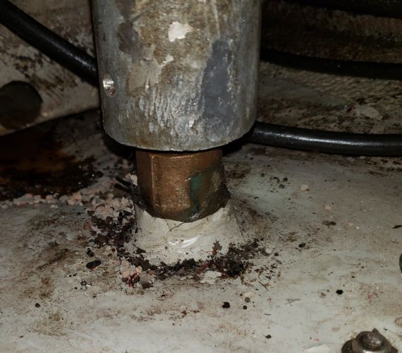

Post Options Post Options   Thanks (0) Thanks(0)   Quote Gary S Quote  Post ReplyReply Direct Link To This Post Posted: October-22-2021 at 7:12pm
Did you remove the pin/bolt through the bottom of the pylon where the cup/socket is glassed to the hull?

Post Options Post Options   Thanks (0) Thanks(0)   Quote klinesd1 Quote  Post ReplyReply Direct Link To This Post Posted: October-23-2021 at 6:00am
There is no fastener of any sort through the brass cup.   I've been soaking with penetrating oil, but no luck.

Post Options Post Options   Thanks (0) Thanks(0)   Quote klinesd1 Quote  Post ReplyReply Direct Link To This Post Posted: October-23-2021 at 6:04am
There is no bolt or fastener in the brass cup.
