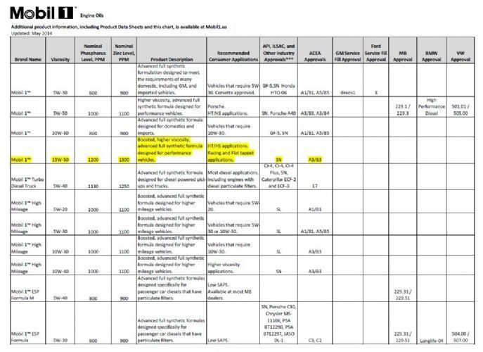

Post Options Post Options   Thanks (0) Thanks(0)   Quote GeoB Quote  Post ReplyReply Direct Link To This Post Posted: August-06-2021 at 8:35pm
Is there a high zinc synthetic oil?
Is Mobil 1 high zinc?
Geo
Post Options Post Options   Thanks (0) Thanks(0)   Quote 8122pbrainard Quote  Post ReplyReply Direct Link To This Post Posted: August-06-2021 at 8:57pm
Post Options Post Options   Thanks (0) Thanks(0)   Quote Jonny Quest Quote  Post ReplyReply Direct Link To This Post Posted: August-06-2021 at 9:31pm
High ZDDP synthetic oils:
Royal Purple HPS
Valvoline VR-1 Full Synthetic
Mobil 1
Red Line
Lucas 20W-50 synthetic
I usually run the Royal Purple or VR-1 synthetic.
