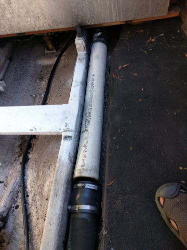

What I found switching to PCM drive to Chevy in a gen 2 SN
Switching to a PCM drive has lowered the front of the engine by 3'3/4in, as for stringer height off the hull I would now shoot for 7in(mine are at 6'1/2) to underside of mounts at the front( note PCM have 3 sizes of engine block mounts for Chevy I'm using the short) and 6in to the underside of the rear mounts. If your going to use a cradle you need to take the thickness off along with the drain tray from the above sizes and all sizes are from engine side of stringers. The prop shaft will need to be shortened by 4in all sizes are working off a distance from end of the log to the coupling of 6'3/4 which leave room to fit a PSS seal and places the engine where its always been but lower. |

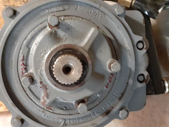

Frank
Since you'll be rebuilding the transmission and putting it on a Reverse Rotation engine, you're gonna need to reindex the pump for Reverse rotation or it won't work at all. I'd print out the picture below and blow it up and hang it on the wall in your garage or wherever. It shows how the arrow (painted red in the picture) on the front of the pump should be oriented for a Reverse Rotation engine The picture needs to rotate 90 degrees clockwise because......well just because |

Hi Keno, I did just rebuild the transmission in June. I am planning on re-indexing the oil pump when the time comes. The entire running gear has been rebuilt with the exception of the engine. Fortunately, most of my mechanical experience is with rebuilding engines. I will probably write up a forum entry on the boats condition when I bought it. I have learned a lot about boats and in particular, Correct Crafts due to the CorrectCraft Fan website. Here is a photo of the exhaust "mufflers" that I found when I got the boat home. I the entire boat had been hacked over the years. |
