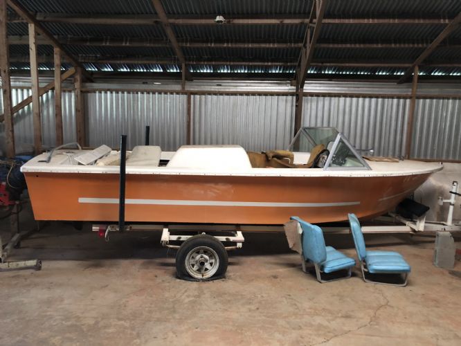

Everyone asked what the next boat project would be for Jesse and me and here it is...
1972 Correct Craft Skier w a 302. EDIT: ***Site was hacked and many pictures lost. I re-added the below pic. Page 4 starts pics again with some older pics as a catch-up on the process*** The Tique project was rewarding and of course will never be 100% complete but we decided to take on another project for the upcoming offseason. This one will not be done in as compressed a time frame as the Tique...so we are telling ourselves and our wives. Jesse and I took an afternoon with ReidP to take a look at some projects and we left owning this one which is very exciting. Thanks Reid! We haven't gone over it with a fine tooth comb yet so we don't know exactly what we have, but we do know that the seats pictured are not for this boat and hopefully we will find the missing fender. Also picked up a 77 Tique hull for parts and the trailer. The hull probably too far gone but we will make that decision on down the road. Hoping the 302 engine could power another boat in the future... And Joe, don't worry, we have our eye on that 1970 Gen 2 red Ski Nautique you mentioned. While we didn't fully commit the day we were there, I would put it at a very high probability that it will have a thread too . Also, we started an instagram page @classiccorrectcrafts to show boat projects and other cool correct craft related pics. Give it a look and give us a follow. We are trying to build the follower base. Thanks. |

Today we put the Skier in its new home for the winter. Going to start working on this one, but it will be slower than the Tique.
We started today by cleaning it out some and trying to fire it up. No clue on the condition of the engine but we hear it ran when it was put up last. Turns well with a bar. No exhaust manifolds yet bc we were just checking to see if the starter worked and whether it got spark and gas. First was spark but before we could get there we ran into another issue. The transmission seems to be stuck in gear so the starter won't turn the engine well. Trans fluid is clean looking and in the middle of the dip stick. The shifter moves the trans in to fwd, neutral and rev just fine but when we crank in any of the three positions the prop moves clockwise. Turns very free in neutral. Rebuid necessary? 71C. How to take it off since the engine mounts are built on to the trans? Prop the bell housing up with a board and remove trans? Also, we are perplexed on our water circulation from the thermostat housing. There seems to be three hoses coming off each side which look like they would all go to exhaust manifolds. I can't find pics in my searches of this setup for 302's. Any help? The manifolds we are putting on only need one hose coming in...what do we do with the rest? Next, while trying to fire it up, we used a handheld remote starter hooked to the solenoid. One clip on the battery post and one on the small post with the ignition wire coming from the neutral safety switch (which works). The solenoid was smoking. Any thoughts there? Has us worried a bit. It is a new style solenoid. Would love to get the motor running even for a sec before pulling it to work on the stringers. Thanks for the help and stay tuned. Hope to give some more to read over the winter. |

It looks like that's a Conqueror/Crusader 302 based on the picture of the thermostat housing and your hose description. TRB has one in a Skier
Strictly a guess here, but if you're using the manifolds from your extra 77 302 engine, why not use the thermostat housing from that also? Or you could buy one of these. It's from Barr and just like what came on Indmar Ford engines. Just one hose to each manifold link Why don't you pull the plugs and see how the engine turns over with the starter. Maybe you have a starter issue or wiring issue. How about trying the starter from the 77 302? Or a known good one from the 78? Or testing the one that's in it now Your transmission with no shaft hooked to it and no drag of any kind on the output side is probably spinning with the engine for that reason especially if the thing has sat for years and the fluid is cold.. You could probably stop the spinning with light pressure from a 2X4 or something along those lines. No fair using body parts like hands or feet to stop it though |

There are no manifolds on either engine. We have a spare set that we will be putting on. They are black rectangular manifolds with a hose that connects the front and rear. I’ll look to see if I have a pic here. We could take the therm housing off the junk tique engine but hoping to keep that engine together too (greedy I know). We have a line on manifolds for that one too. Otherwise it is fully intact (whether it runs is another ballgame).
We will try the block on the prop to see if it stops the trans. We have an extra starter or two that we can try. As for cooling, on each side, could we connect an output hose to the manifolds, and connect one hose in a U to the other outputs. Take the side outputs from 3 to 1? Any thoughts on the smoking solenoid? Pretty sure the carb is marine. Have seen many threads over the years about j tubes. The 4160 on the junk tique does have j tubes. Will check the number on this one. |

I figure you mean you'll try a block on the output coupling of the transmission since the shaft is disconnected
Smoking solenoid is probably due to bad connections/wires or the starter is drawing lots of current, either because it's bad or the engine is too hard to turn. Installing one of the extra known good starters should tell you a lot. |

What’s the SK#? I see a lot of details that may indicate 73 instead of 72.

Serial number: 3402

The latest 72 I have written down is in the 3340’s and was built end of May ‘72... with the switchover in July you’re prpbablh right in the edge one way or the other. Lifting rings match the typical 72’s so it’s a mixed bag. No HIN on the transom I assume? |

Correct. No HIN on the transom.
Does the throttle give any hints? Or was that pretty std in that time period? Also, would the twin airguides have been from factory? Whatever the year we are ready to get her prettied up and running. Wouldn’t mind stroking out one of these 302s but first things first. |

I’ve only seen that throttle on 73’s, but without a HIN on the transom that may make it a very late ‘72.
No, the airguides were added by a PO. Most, if not all skiers came without any, it’s possible that a single was offered but i suspect most were added by dealers or after the fact due to widely varying styles and mounting configuration. Only SN’s of the era got dual. Fuel gauge, hour meter and horn were all optional on the Skier, it was a bare bones model. |

Back to the issues at hand...plugging up some output holes on my tstat and potential for having to rebuild a trans. Would love some thoughts on the tstat working with a single hose manifold. On the trans side I’ll follow Ken’s advice on blocking and altering other starters. |

Looks to me to be a interceptor conversion with thermo electron thermostat housing. The throttle is stock for that boat. They used the MV control on the Ski Nautique. Later on they put the MV on all the models.
