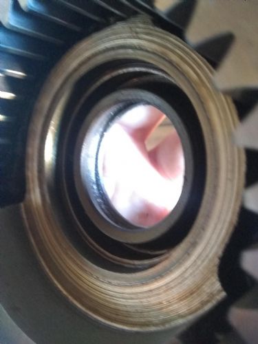

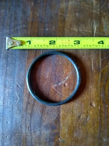

Ok, so the o-ring on the left is a mystery part. I don't know where it came from. I fear it might be a MOFWS (magnet on the flywheel syndrome) On the blowup schematic it looks like part 83 which looks like it goes into part 84, which I did not disassemble. I don't see where else it could go. Also, the pic on the right is the inside of the pump. Do those groves look deep enough to cause a failure? Thanks all.

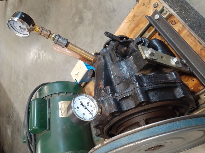

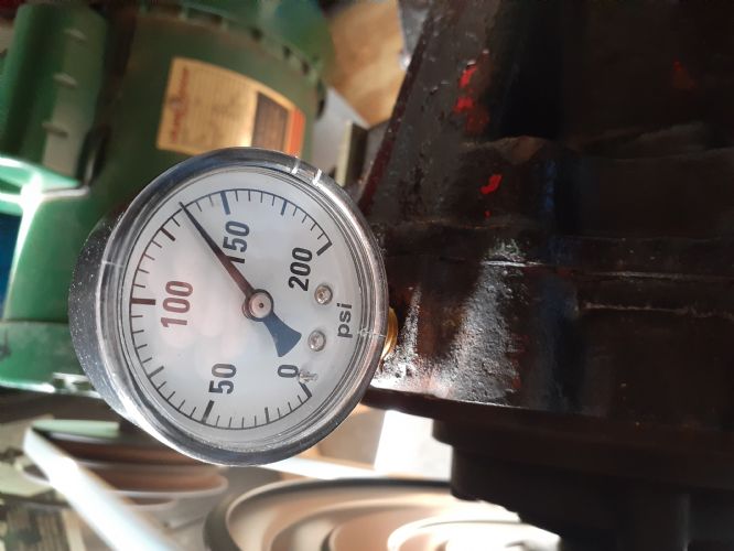

Bill
You need to check pressure in 2 different places if you want to check your pressure in Neutral, Forward and Reverse. The spot you describe hooking the gauge to is reading line pressure and with the transmission in neutral at 600 ish RPM, it should read 120 or so PSI. If you shift to forward it should read the same. If it's lower, then you have forward clutch leakage. To read pressure to the reverse clutches there is a 1/4 inch pipe plug at the top front of the transmission in the forward reverse adapter . Here's a picture of a gauge hooked there. You'll have to rotate the picture 90 degrees. The transmission is on a test rig but it shows where the gauge gets hooked up. It should read the same 120 or so as the line pressure at 600 ish RPM. This one is about 135 or so at a little higher RPM Now if you think the shift valve/pressure regulator is your problem after you viciously attacked it with an automotive jack a while back I have a suggestion. I just happen to know "this guy" who would send you a good shift valve/regulator so you could put it in the transmission and see if things are any different. Even if you have no water to launch it, you could sit in the driveway on the hose and do some "make believe boating" and see if it shifts in and out of the gears the way it should. It'll at least tell you if that's your problem and as an added bonus, it'll keep one of the more highly entertaining threads here on CCF alive and kickin'. Send me a PM with your address, and I can get after "that guy" to ship it to you on Monday, probably thru the USPS. If it works, you could keep it and send me back your bad one so I could entertain myself taking it apart Sounds like a fair trade to me, but then again I ain't too smart Late addition..........another picture showing both test connections |

Keno, that is a world class offer, tell that guy nice work when you see him.
William777
Senior Member Joined: October-21-2017 Location: Northern CA Status: Offline Points: 149 |
Keno, tell that guy he's a gem! The gem of gems! What an amazing offer! It will be very nice to know if it's the valve. Thank you so much! I will go through the pressures tomorrow and report back. Thank you fanoccfan! William means stubbornation in some language!
