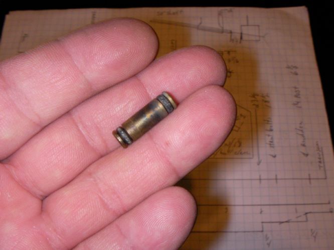

Want a good laugh ? Look what i found !
My windows in the dining room go all the way to the floor, 1959 jalhousie's original to the house.
I sweep every day, vacuum couple times a week, i don't always open the blinds but today on the floor in the corner of the front window laying in the grout line was this, wouldn't be surprised if it was the culprit pouring gas down the primaries but not real sure which side of the carb it's from.

Umm...............what are you doing losing carburetor parts in the dining room?
That your accelerator pump transfer tube, there's only one on your 4160 and it's on the primary metering block.(or at least it would be if you didn't lose it ) Wink
Earlier 4160's had an orifice and a different gasket between the metering block and the body instead of this tube..
In your carburetor, with that not installed you have a huge unmetered internal opening and the engine runs crazy rich, so I'd figure that was your problem

In my case at least the accelerator pump transfer tube was a 729 dollar part.
Oh well maybe the old carb is or could be a good if properly rebuilt.
It's easy to lose parts in the dining room when the table in there is the only clean and uncluttered workbench on the property.
