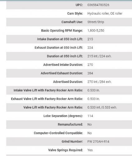

GottaSki ![]() Grand Poobah ![]() Joined: April-21-2005 Location: NE CT Status: Offline Points: 3372 |
this is intriguing, lift > .500, 215/224 and big 114 LSA, COMP Cams Blower and Turbo Camshafts 35-304-8 |

81nautique ![]() Grand Poobah ![]() ![]() Joined: September-03-2005 Location: Big Rock, Il Status: Offline Points: 5817 |
Thanks Gottaski for the research. I did end getting to talk to Scott at Cam Research, his recommendation was a bit milder than those with lift just shy of .5 and 112 LSA. Haven’t made a decision yet
