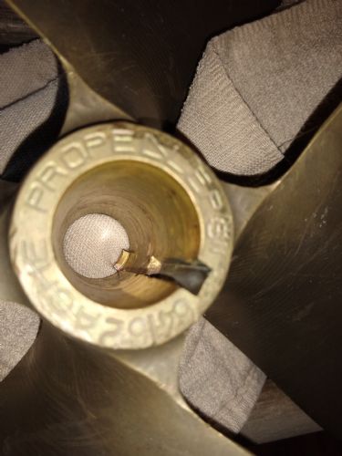

Hi All,
I read through the prop pages and didn't see any mention of the issue I am having on my 1985/2001. I am removing the prop for strut bearing replacement and possible prop replacement. The prop is loose but the key is stuck in the prop so the prop will not come off.   I have tapped on the key with a narrow punch but it is not moving. Also soaked in PB blaster no help yet.
The prop hasn't been off for 20 plus years, yes that means my strut bearings have not been replaced in 20 plus years.
Any ideas?

Post Options Post Options   Thanks (0) Thanks(0)   Quote KENO Quote  Post ReplyReply Direct Link To This Post Posted: May-17-2021 at 6:16am
I'm a little slower than normal this morning Pete................the key is stuck in the prop so why don't you explain how the puller will get the key out of the prop

Post Options Post Options   Thanks (0) Thanks(0)   Quote KENO Quote  Post ReplyReply Direct Link To This Post Posted: May-17-2021 at 10:05am
Well Pete, you can read it however you want to but obviously you've never tried to get a prop off that's been loosened with the puller and the key is stuck in the prop like he stated
It can't be done without destroying/damaging something because that key hits the threads when you're trying to get the prop the rest of the way off the shaft.
The key has to be out of the prop if you want to get it off without damaging anything
Give it a try.
Post Options Post Options   Thanks (0) Thanks(0)   Quote TRBenj Quote  Post ReplyReply Direct Link To This Post Posted: May-17-2021 at 12:03pm
I don’t see why this is so hard to understand, ha. The solution, unfortunately, is a PITA.
The last time this happened to me, I took a grinder to the shaft threads in order to give the prop (with stick key) a way off. Not pretty, but effective- and I have used the shaft subsequently (just clean up the threads).
Getting the key out of the prop even once it’s off the shaft is still a big problem- but if the prop is old enough to have this happen to it, it’s likely a mantle ornament anyways.

Post Options Post Options   Thanks (0) Thanks(0)   Quote TRBenj Quote  Post ReplyReply Direct Link To This Post Posted: May-17-2021 at 1:25pm
0% chance of getting my most recent stuck key past the threads without the clearance job… the location within the taper where the key is stuck probably is a factor in whether it’ll sneak past the threads or not.

TRBenj,
That would do it, not sure I could make such a cut under the boat.  I may try to pull the whole thing out as I wanted to change strut bearings too.
