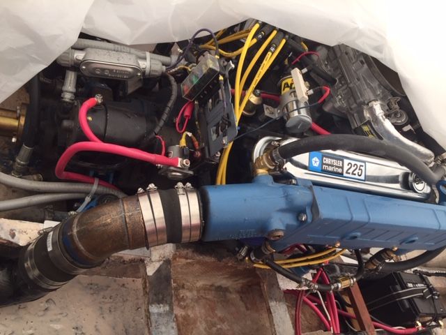

Only thing on engine not touched is piston and heads. New alt, reman starter, Rebiuld original CARTER carb, rebuilt Sherwood pertronix. All rewired all new hoses and manifold
Blah blah blah. I got lucky motor is smooth and tight

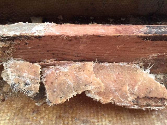

Glad you are finding stringers to be in decent shape.  Boat looks great by the way.  Now to really challenge you get a video or 2 of it running on the water up on Youtube and link them here.
Not sure I would have put foam back in.  I don't know how people feel about foam as a safety item, for me if my '63 (never had foam) sinks, it sinks.  One time in really rough water on a lake I shouldn't have been out on, I tied a lifejacket and inflated fender to my anchor line and the other end to the boat so if it sunk I'd have a chance to find it again later.  Not sure I'm proud of that one, but it was an adventure. Smile My point is having a bilge that is dry and can be cleaned up seems better to me than having foam, but maybe I'm wrong about that, not sure.

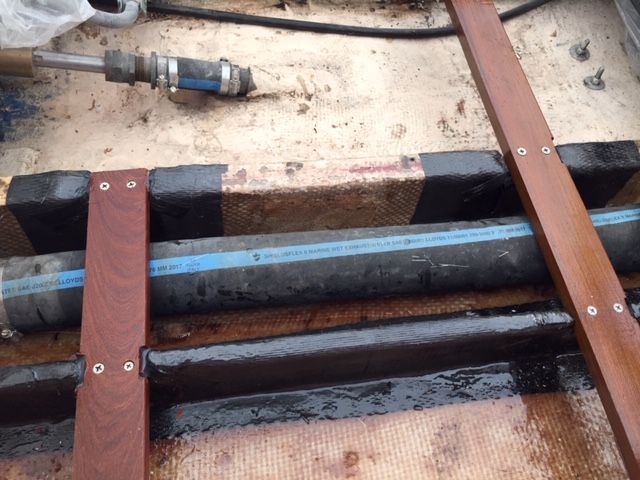

Stringers all looked amazing, glass still stuck really well. Replaced the side to side ‘ribs’ with IPE (ironwood). Also trimmed and cleaned up the glass connections between stringers and ribs. Trimmed back about 3”x3” , reglassed with 2 thick pieces of matte to fir out and match
Then 2 thick progressive larger with cabosil to fill then 2 thin to smooth out
Then carbon fiber (black) to tie everything
thing together and look uniform
Marine poplar plywood for new floor, several coats spar.
Ring and finger installed now

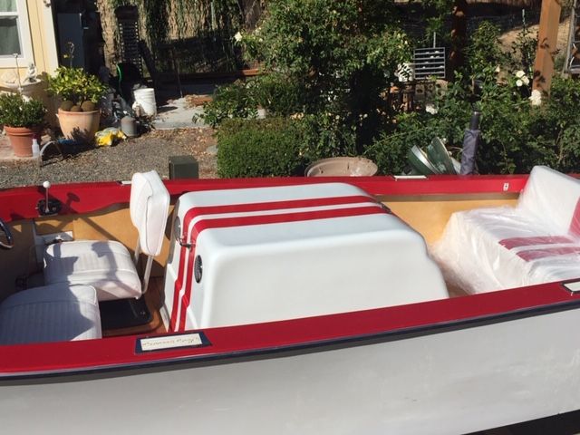

I had my rear end painted.
http://www.correctcraftfan.com/forum/uploads/18449/199780D0-D541-4322-A7B1-99D092DCF470.jpeg
Here's Daryn's rear end:
