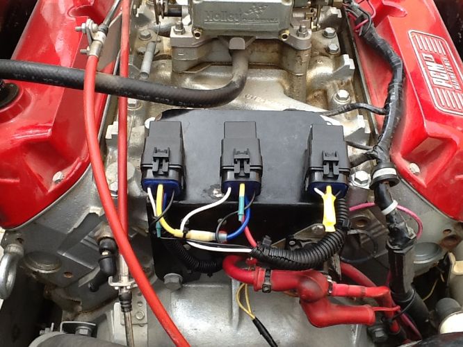

I recently replaced my Protec with a DUI. I used the same parts and did the installation basically the same as JPASS but decided to install a couple of relays as well. Here is the schematic and a link to the relays that I used
Link to Summit Racing Relays P/N 5593PT
The relays connect battery voltage directly from the 50amp breaker to the DUI rather than the existing method of routing the voltage through the dash and key switch.
Relay #1 is normally open and will close when the key is turned to the on or start position applying voltage to the DUI.
Relay #2 is normally closed and will open when the existing protec water temp switch detects an over temp condition. This will kill the engine if it starts to overheat.
I was originally going to use the oil pressure switch as well but when starting the engine it takes a few cranks to get enough pressure to open the switch so the engine didn't start right away. I just disconnected the wire at the oil pressure switch and capped it off.
I mounted a third relay as a spare. It's not connected to anything.
Post Options Post Options   Thanks (0) Thanks(0)   Quote Jonny Quest Quote  Post ReplyReply Direct Link To This Post Posted: April-01-2019 at 1:51am
Nice, clean installation. I like the dedicated relay for the DUI dizzy.
Post Options Post Options   Thanks (0) Thanks(0)   Quote KENO Quote  Post ReplyReply Direct Link To This Post Posted: April-01-2019 at 8:36am
This may seem rather silly of me, but why would you want to automatically turn off the engine at 200 degrees?
It sounds like a good idea to protect the engine, but I'd say it's a "not so good idea" for the safety of you and anybody else in your boat.
It takes away the ability of the driver to survey the situation and decide whether to keep running the engine till it self destructs if necessary.
Take a situation where you're in the boat with serious medical issues like a heart attack for example.
The driver is headed for the dock/launch ramp where medical assistance is waiting but your engine temp hits 200 degrees and it shuts down about 1/4 mile from life saving help.
I guess you could say, "well I'm gonna die out here but don't worry, we saved the engine" or on the other hand " we cooked the engine but at least I'm still alive"
It was built with the limp feature instead of automatically turning off the engine on low oil pressure or high water temp for a reason.

Well Ken, while you’re clutching your chest dying just pop open the dog box and jump the relay! Did I miss where it shuts off at 200? That’s a lil low, I’d step it up to at least 230.

Post Options Post Options   Thanks (0) Thanks(0)   Quote 8122pbrainard Quote  Post ReplyReply Direct Link To This Post Posted: April-01-2019 at 12:28pm
or cut ether wires at terminal 86.
At what temperature does the temp switch close? 200?

Post Options Post Options   Thanks (0) Thanks(0)   Quote desertskier Quote  Post ReplyReply Direct Link To This Post Posted: April-01-2019 at 12:44pm
I did give that some thought. What I considered is that during 1600 hours of operation my boat has never overheated or gone into limp mode (except when the old wiring had too much IR drop - long time ago). Although the scenarios you mention and others are possible I believe the risk is extremely low. It would be nice to have the limp mode feature still but without it I would rather save the motor.
My boat doesn't have the dash alarm/lights but for those that do it would be easy to replace relay #2 with a timer relay. You could set it to a few minutes so your alarm went off before it killed the engine.
I was also curious what the DUI does when the input voltage drops but I didn't experiment with that yet. It may start running crappy at some point which would give the driver a heads up. So all you would need is a voltage divider on the output of relay #2 that connects to the DUI wire.
According to skidim the switch closes at 210. For some reason I thought I had read somewhere it was higher than that. If it turns out to be a problem it's easy to disconnect unless of course I had a heart attack and crashed then it would be harder.

Post Options Post Options   Thanks (0) Thanks(0)   Quote desertskier Quote  Post ReplyReply Direct Link To This Post Posted: April-01-2019 at 12:57pm
Installing just the first relay would be really easy since you have already done everything else. Just connect 87 to the dizzy without the second relay. I know how much you like projects! But if you want to protect that new roller motor I would install #2 also.
Post Options Post Options   Thanks (0) Thanks(0)   Quote KENO Quote  Post ReplyReply Direct Link To This Post Posted: April-01-2019 at 2:37pm
Good to know you gave it some thought
I've seen the switch listed in PCM literature as both 210 degrees and 200 degrees depending on where you look. It's the same part number for a ProTec engine and a GT40 engine.
If I wanted some kind of protection/warning from the oil pressure and/or water temperature switches, I'd probably wire both to relays that fed a loud, obnoxious horn to let the driver know there's a problem and he/she could turn the engine off or keep running it depending on the situation.
That way O-76 or whoever's driving wouldn't have to find the right relay and yank it and Pete wouldn't have to pull out his wire cutters and snip the right wire in the middle of a "not so good" situation.
I suppose in the end, it's whatever you're comfortable with
