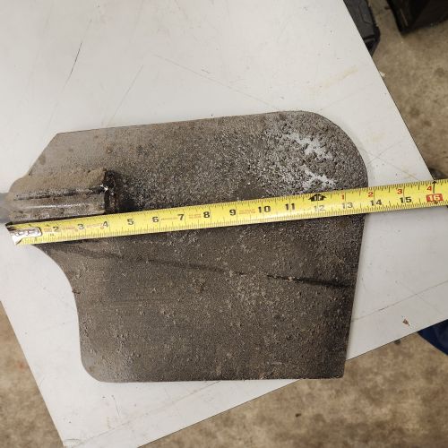

This is the current rudder it seems too small does anyone have a picture of a rudder from a fish nautique or similar 23ft cc?

When i had my fish nautique everything i read about them pointed to them coming with the standard CC 11A rudder, but I've always thought that to be either, wrong data or horrible design on CCs part.
I bought and put one on since what mine originally had was bent, and with the 11A it handled like garbage in any current and was unacceptable to me.
I eventually made a new rudder as a test and it made low speed handling much better, compared to the 11A that i had picked up. I believe i still have it in the garage because i ultimately sold it with the 11A and a recommendation of having a new one built.
I will get some dimensions for you if you in case you want to have one made up.
Edit* here's some pictures of it in this thread.
In reverse you will not be able to do much in the way of steering.  The deep vee especially doesn't like to move sideways.
My fish had a 1-1/8 shaft and i had very good luck spinning the acme 524.
You may want to double check your shaft dimensions. because i believe the sea and the fish were the same. which should make yours 1-1/8 The wheel that's on it should have some identifying features either on the hub under the jam nut or near the root of the blade.

10.25 length from edge to edge.
14" total height of the rudder blade.

I don't know what kind of conditions and currents you get on the west coast but out here on the east coast and with the type of fishing i do(lobstering and striper mostly) i needed low speed maneuverability so the larger rudder did make a difference for me. if all you care about is going fast the 11A is probably your better bet.
No fisherman in history has ever come home in a 1/4 following sea and said,"Man i wish my rudder was smaller."
If you want that rudder to try out for performance/size I am open to offers. it's just sitting, waiting for me to cut it up for another project.
If you keep up with the zincs and keep good bottom paint on it you'll prob get a decent life out of it.
But that blade is carbon steel so don't expect it to last a lifetime. The rudder stock is stainless.
And yes, with prices of material now, i would expect a build-new rudder of all stainless will be close to the $1000 mark.
I do have the capability of building one out of all stainless if you want me to look up material and give you a quote feel free to message me. I would need to confirm some specs like stock diameter and linkage configuration for steering.
You can also search places like ebay for used chris craft, blackfin, shamrock and similar rudders would be cheaper than build new.
