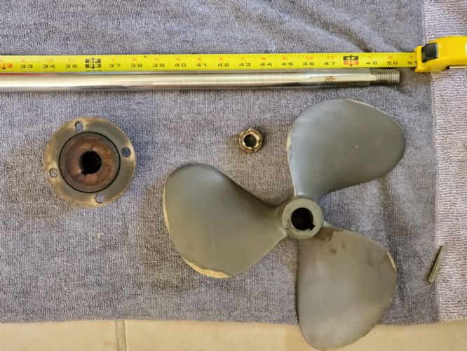

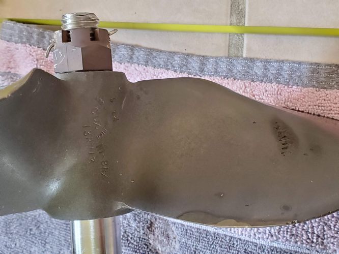

Removing the old parts went smoothly. I removed the rudder, then slid out driveshaft. The coupler came off with some PB Blaster and some taps with a rubber mallet.
The prop on this boat was a Michigan Wheel 13x13 RH. The folks at general propeller thought that was strange.
Here's some pictures:
gun-driver, im with wayoutthere, I don't think I can use a dripless seal because I don't have the plumbing for it. I put a float switch into the bilge so it auto pumps and the leaking water isn't a concern.
New parts are on their way, and I'll post again when I start putting it back together.
Here's the best photo I can offer for tribute... It will look a lot better when we can get back out on the water
