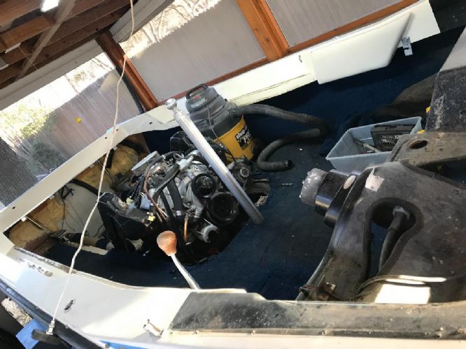

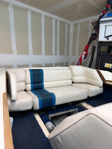

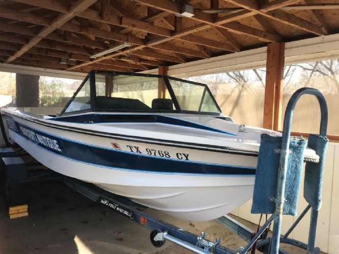

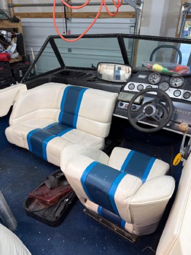

I bought the boat in December 2024. This is my 4th BFN. It sat for years indoors and then moved outside with a tarp that leaked but the plug was out….LOL The boat needs a lot of work. I started taking it apart last week so I could get a better assessment and get a game plan to restore it. Engine rotates fine with plugs out and lubricant in
cylinders. The floor and all Stringers need replacement. Upholstery is mostly
there but will be replaced 100%. The Gel Coat is semi good…..Well see if it can
be brought back.The Dash is 100% complete and pretty good condition.I removed the windshield, dash pod, interior, all
accessories, fuel tank, prop, deck ect. Disassembled the motor down to the
short block with everything ID. |

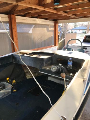

Update on the tear-down. I'm at the point of pulling the engine/trans.
It easy to tear one down.....Putting it back together is another story...... ![]() ![]() ![]() |

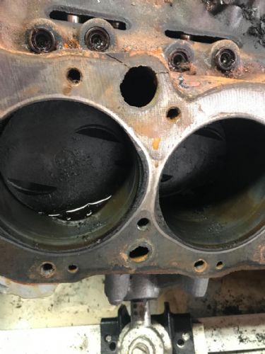

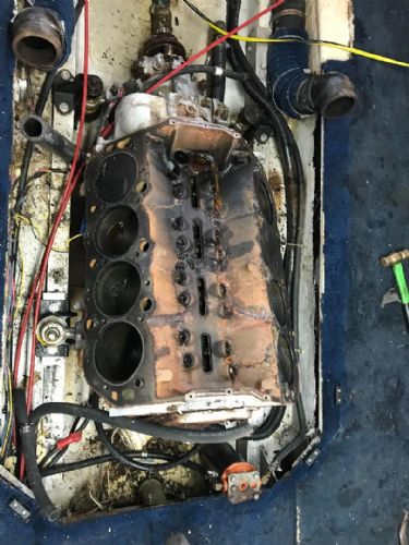

Started to tear down the 454 so it would not be so heave lifting out of the boat. Good news the Top end came apart no problem......Bad news is the Block is cracked. looks like a Freeze crack. I am kinda not surprised due to the poor care of the boat. I have found another Gen 4 - 454 Block that is fresh machined .030 over and 4 Bolt mains. The seller also had a nice set of 336781 Heads that I purchased which will make more power. ![]() ![]() ![]() |

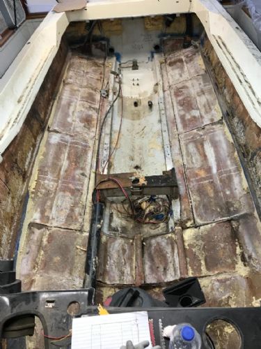

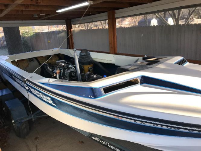

Removed all the wood except for the 2 Main Stringers. My plan is to
support the hull using 5 point contact 2 at rear edges and 2 just in front of
the dash outside area and one support under the Keel.........while taking pressure off the trailer. Trailer will stay
under the boat but semi loose. (BTW I am open to input with this if there
is a better way)!!!!! ![]() |
