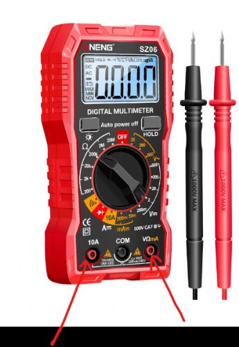

Originally posted by Mpost Mpost wrote:
If you have a VOM you can do a current check with it to determine if there is any current draw on each wire. There is usually a 10 amp and a MA (milliamp) connection on most VOMs. connect the lead to the 10Amp to the Positive battery terminal and the COM (ground) to the wire you want to test and check the reading. If nothing shows up on the 10Amp plug try the MA plug.
I have used this many times to find a small drain in vehicles and boats.
If it is a significant drain a test light may even show the wire at fault.
I tried this but must be doing something wrong. With the power switch in the ‘all off position’, When I pull the main battery cable terminal and check it I get 12v. When I individually check the other 5 wires connected to the battery I get a range from 5mA to 9A.

Mpost View Drop Down
Joined: July-05-2018
Location: Monticello, MN
Points: 332
Post Options Post Options   Thanks (0) Thanks(0)   Quote Mpost Quote  Post ReplyReply Direct Link To This Post Posted: May-15-2024 at 9:34am

Post Options Post Options   Thanks (0) Thanks(0)   Quote MrMcD Quote  Post ReplyReply Direct Link To This Post Posted: May-13-2024 at 1:40am
Every Boat owner should also own a good battery charger.  Minimum of 10 AMP charger, new chargers are fully automated to keep you from over charging your battery.   A must have tool.
When I park my boat for the winter I do that with the battery cable disconnected so nothing can drain the battery.   Radio's can give you a constant low voltage or mil volt drain that over 3 mos time will drain a battery.
It sounds like you have a parasitic drain, follow Kens advice above.  Get a Multi Tester and start checking each wire run from the fuse to the battery,  One is draining your battery you just need to find out which one.  A hot wire is hitting a partial ground, a full ground would allow the wire to melt.   As fast as yours is draining you might find it with a temperature check on your wires with everything off and the battery fully charged and Hooked up I am thinking one wire is going to be warmer than the others where your drain is located.   The Multi Meter will also allow you to do an AMP drain or Voltage Drop test on each circuit to help find the issue.   Hope it is obvious and found quickly.
