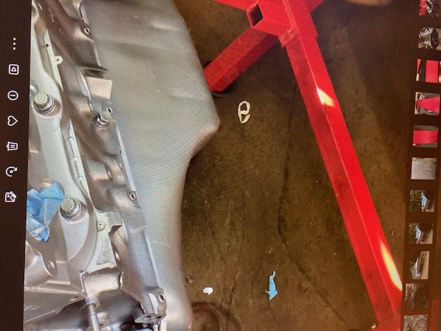

I have a 1990 454 BBC that does not have a drain plug on the port side, I have a clear view of the whole block. on the star side it has the normal 1/4 inch drain plug on the port side all it has is the small oil. galley plugs 1/8 plugs evenly spaced no drain plug any where. Tried to remove the 1/8 inch drain plug along the rail with heat no luck. I do not want to drill it out if its the oil gallery because of metal shavings. I need help thank you Joe

Riley ![]() Grand Poobah ![]() ![]() Joined: January-19-2004 Location: Portland, ME Status: Offline Points: 7953 |
![]() Don't know why the image flipped. Engine is probably a 1980's.

63 Skier if you google it, every block has two a lot of pictures exactly where it should be. I worked in the Marine industry for many years and winterized many craft and never seen this before. The block is actually in my 1970 Chevelle. removed the header everything on the drivers side which is the left side of the block. Thank You for the response. Joe

Seems impossible the block could be lacking it when new, any chance someone filled it with weld at some point?

And here I thought I had the only 454 block with only 1 block drain.
Same as you Joe, just nothing there. Must have been a hungover Monday morning block. Since it was going into a boat, I figured a drain on that side would be kinda handy. The solution at the time was to pop the rear freeze/core/casting plug on that side and make a "custom" plug with a drain in it. It worked good, left a little water, but some antifreeze took care of that when winterizing.
