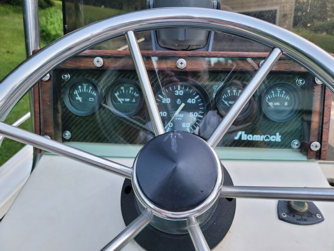

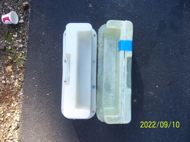

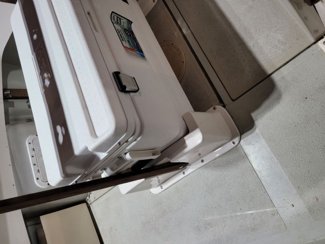

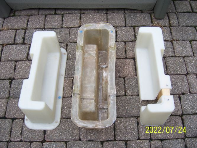

David they were thinking and the plan was that VW was going to sell the 4 cylinder version and Porsche the upgraded 6 cylinder. VW pulled out and left Porsche holding the bag so they ended up selling both models. I got rid of my Avalanche and did something I said I'd never do again and thats buy a diesel- a Cayenne. VW drivetrain in a Porsche wrapper like the old days. A total impulsive buy saw it when the Mrs Macan S was in for service. Said I'd never buy a black car again as well.... I know many are not too intrested in non Correct Crafts but as to boat projects I had to do mine in the summer since this boat was going south. Picked this baby Shamrock up a year and a half ago but didn't have a dock space for it yet so I was in no hurry. Well last July a spot opened up so now it was a race against time. It had been sitting for something like 7 years. Biggest project was the helm seat they originally used a Igloo cooler and naturally they don't make that exact one that fit the oem base, anyway both it and the original blow molded base was sun damaged. So I used the best one to make a mold and modified it to fit the new coolers base. Also tried my hand at making a carbon fiber dash and cutting new plexiglas for the dash. Next summer I'm going to hunt for a new engine since the old Indmar 4 cyl GM block is tired and has typical cracking. Mercruiser,Volvo and OMC all used the same basic engine in their I/O's just have to find a pre 91 so it will easily bolt up to the Velvet drive.
Here are some pics of the cooler/seat mount - I first hot glued together the best original one to splash a mold off of. I then cut that into 3rds, extending it approx an inch evenly on each side of the teak seat backrest and glassing that back together so it fit the new style cooler. Then I cut them lengthwise making two halfs to make the new molded ones easier to remove. After the fit was correct I coated them with orange tooling gel. Coated that with PVA, I laid up epoxy and mat to the thickness I needed. After removal I bonded them together repaired any defects and Imron'd them. The original dash was plastic and had broken up due to age and heat. Made the new one out of carbon fiber just to try to see how and if I could do it. Last picture is of the PO when he had it, some of you might know him. |

Gary, How high did those cooler mounts pick the cooler up? I have fat 20 shamrock and need a couple more inches in my set up. cant sit on the seat and look over the dash,, i am short.. |
1993 Shamrock "fat" 20. 2008 Nautique 196 5.0 |
Jody it is 20" from the floor to the top of the cooler. I'm 6' and can see over the console fine but I suspect this console is on the small side as well. Do the 20's use the same cooler seat combo's? If they do and their in good shape maybe you could make a spacer to put between the floor and the mount to raise it?
