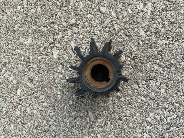

I replaced the impeller earlier this year, could this be the culprit?
KENO ![]() Grand Poobah ![]() Joined: June-06-2004 Location: United States Status: Online Points: 10932 |
I don't think you'll hear rubber "rattling"
