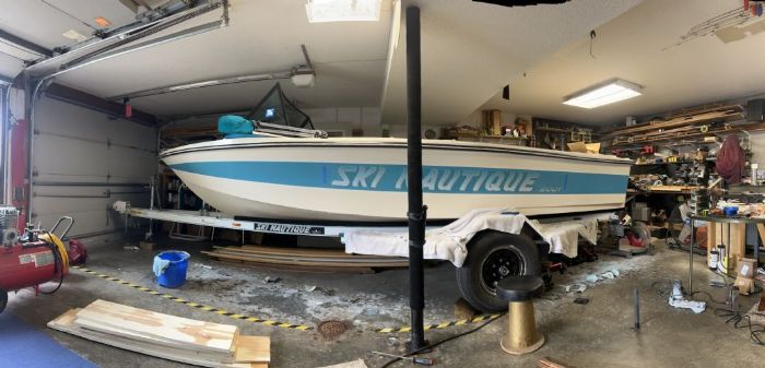

Back in late August I was out on the water enjoying the morning when I finally realize its time to do the final piece of restoring my Nautique. The aquamarine stripe was looking more of a blueish green from sunlight reflecting off the water. I have already done the transom this past spring removing the oxidation. So, on Labor Day weekend, I started removing the decals from both side except the “Ski Nautique 2001” decal.  I started backwards as to what grade of sand paper to start with and it ended up being the 400. The 400 grit was done with an orbital sander. Then hand sanded again with 400 and work my way back up to 1000 at this time until I will be able to remove the Nautique decal. Once I remove both of those decals I was continue hand sanding up to 1500 and then switch over to buffing the sides out. But this is where I am at today. Decals on both sides have been traced and sent out. Waiting to hear back from the graphic shop for final approval and decals. There have been 270 + pictures taken of both side decals with some having measurements to place the decals back on.  I’m excited to get this behind me but I still have a lot of work ahead. Plus, all the other “honey do” list I have at home. And most of you know whose projects comes first?  So even though the season ended sooner here for me, I definitely got a jump on this before spring comes back around. The objective is to have this done by Christmas

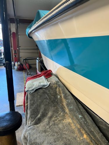

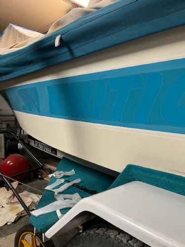

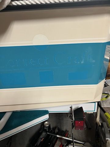

Received the new Ski Nautique decal last week so I started removing the old ones and sanded those areas, along with the both entire sides up to 1500. So, moving onto buffing this week.
Bringing the gelcoat back to life is a very patient process to say the least. Being at the age that I am at, I will say I do have more patience to do this labor of love than when I was younger. It is a slow process and depending how detailed you want to be, it can be time consuming. I’m being time consuming with this girl.
I spent almost 3 hours getting 2/3 of the port side last night with 3M Super Duty Rubbing Compound. The first hour I will say very frustrating for me but after calling a friend who’s in the car body repair business, He talk me through the process of buffing. Think small.  So here are some pictures before and after the first pass.

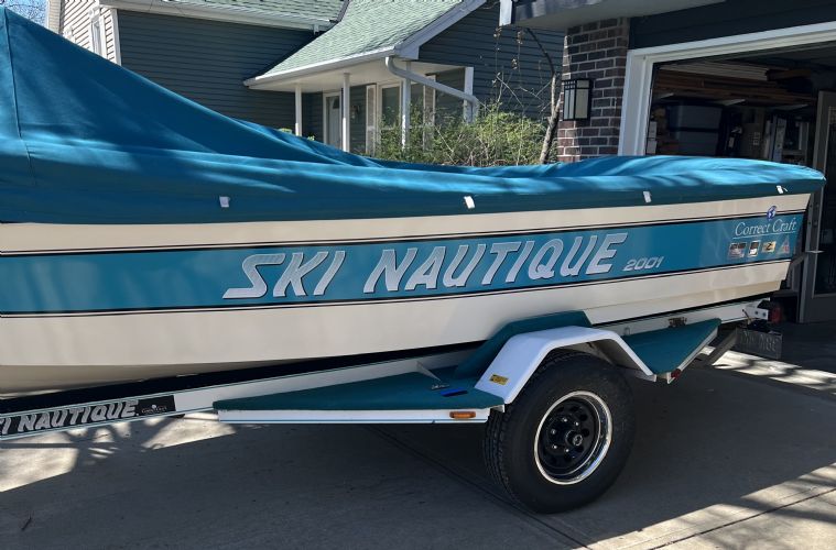

Post Options Post Options   Thanks (0) Thanks(0)   Quote pjsmoreno Quote  Post ReplyReply Direct Link To This Post Posted: April-27-2023 at 7:32am
Been a long process this past season break but she is completed. Very happy on how it looks. She'll look nicer once I get her on the water.
