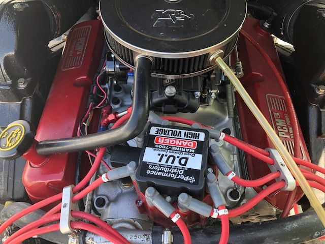

For reference, this is what my QuickFuel & D.U.I. project looked like when completed:
And for those of you with sharp eyes, the braided  stainless steel fuel line did not carry the USCG stamp of approval.
Some might notice that it's an M650 in your picture Wink and some might wonder if he (Ostler 917) bought an M600 or 650 and what kit he bought with the flame arrestor and fuel line
Maybe a kit from Jeg's?
Post Options Post Options   Thanks (0) Thanks(0)   Quote Jonny Quest Quote  Post ReplyReply Direct Link To This Post Posted: April-06-2022 at 9:32pm
Post Options Post Options   Thanks (0) Thanks(0)   Quote Jonny Quest Quote  Post ReplyReply Direct Link To This Post Posted: April-06-2022 at 9:01pm
The fuel pump clear safety hose has been "hacked" and doesn't run up to the carb, but rather down into the bilge.  That might be the biggest fire risk problem in the engine compartment.  Also, it also appears that the previous owner ran out of red plug wires and went with a smaller diameter yellow wire.  Can't be having that.  The red wires will get jealous and start cross-firing.

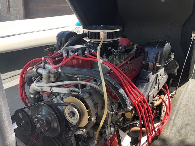

Post Options Post Options   Thanks (0) Thanks(0)   Quote KENO Quote  Post ReplyReply Direct Link To This Post Posted: April-06-2022 at 7:27pm
No pictures of the starter? Kinda wondering how they determined it was an automotive starter.
Maybe a label or part number or something?
It looks like you have some belt alignment issues too Wink

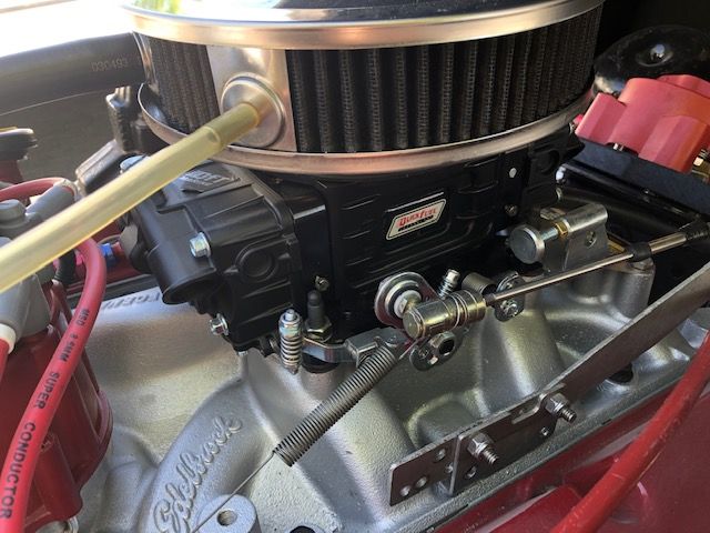

Alright, after a good long Convo with Jonny Quest, and the service center that found all this hack job stuff, I've opted to grab a new quick fuel Holley carb which comes with a new fuel line and spark arrestor. Also got A new marine starter, and a D.U.I. distributer. I'll definitely post an update once I get it up and running again, and will feel so much better not running a bunch of automotive parts on this boat. Cheers to not exploding on the water.
1992 Ski Brendella Super Comp
Ostler917 View Drop Down
Joined: April-05-2022
Location: 98146
Points: 8
Post Options Post Options   Thanks (0) Thanks(0)   Quote Ostler917 Quote  Post ReplyReply Direct Link To This Post Posted: April-06-2022 at 3:45pm
Alright hopefully this works, having a hard time figuring out the images. Here are a handful.
Post Options Post Options   Thanks (0) Thanks(0)   Quote Jonny Quest Quote  Post ReplyReply Direct Link To This Post Posted: April-06-2022 at 3:20pm
The non-marine components can be a bit troubling from the safety standpoint.  Does the automotive distributor have a vacuum advance?  Post a couple of pics so we can get a good look at the hack-job conversion.
Now I've been accused that I like to spend YOUR money.  That's correct.  As a general rule, I like to use high quality parts and I'm not a stickler about keeping things "original".  So, I recommend the D.U.I. distributor and the QuickFuel carb option.  I'll even put my money where my keyboard is...That is what I did to my 1994 PCM ProTec engine when the fancy electronics crapped-out.  I took it a step further and added an Edelbrock Performer RPM intake manifold.  When the dust settled, that engine was a very strong runner.  Now since I didn't buy the boat brand new, I can't prove that the performance of the engine with the fancy new components was stronger than the factory-fresh engine with ProTec, but the engine was a beast.  It feels every bit as strong as my GT40.  Just my 2¢
