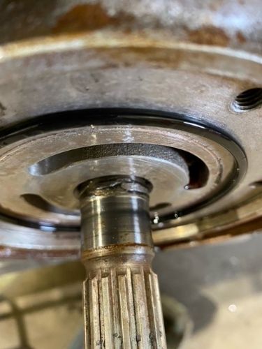

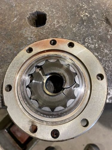

Pulled the pump face and found the gear in three pieces and the input shaft scalded because of the gear failure.

KENO ![]() Grand Poobah ![]() Joined: June-06-2004 Location: United States Status: Offline Points: 11275 |
Not yet Bill, keno439@gmail.com I hope it's a picture or 2 I just hate it when that happens ![]() Probably time to talk to Joe and see what he has in the parts collection |
Here are Bill's pictures of the shaft and the broken inner gear of the pump ![]() ![]() |
Jonny Quest ![]() Grand Poobah ![]() ![]() Joined: August-20-2013 Location: Utah--via Texas Status: Offline Points: 3032 |
Dang! I just HATE when that happens. Too bad the shaft is toast.

Did he tell you if it had other issues that caused the gear to break? Or it just broke?
fanofccfan ![]() Platinum Member ![]() ![]() Joined: December-13-2009 Location: North Bend NE Status: Offline Points: 1801 |
He did wonder of it ever got hot. Me not knowing the entire history of the boat can not answer that. I will say that after I looked at the broken gear it doesn’t appear to be all that sturdy. A little ball is used instead of a square key to keep it from spinning on the shaft. My untrained eye would have me believe that is where the failure began..🤷🏻♂️
