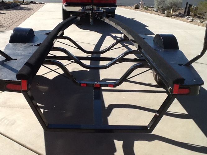

I guess it depends on what trailer you have. My prop guard can handle the weight of the boat and trailer no problem. I use it as a jack point all the time. Mine is box steel.

I'm going to add wheels, love the way that install looks. I end up dragging and lifting the entire boat/trailer occasionally, no damage to the guard. Having said that, it's a pretty huge shear load without the wheels so I think adding them will make the prop guard much less likely to be damaged.
