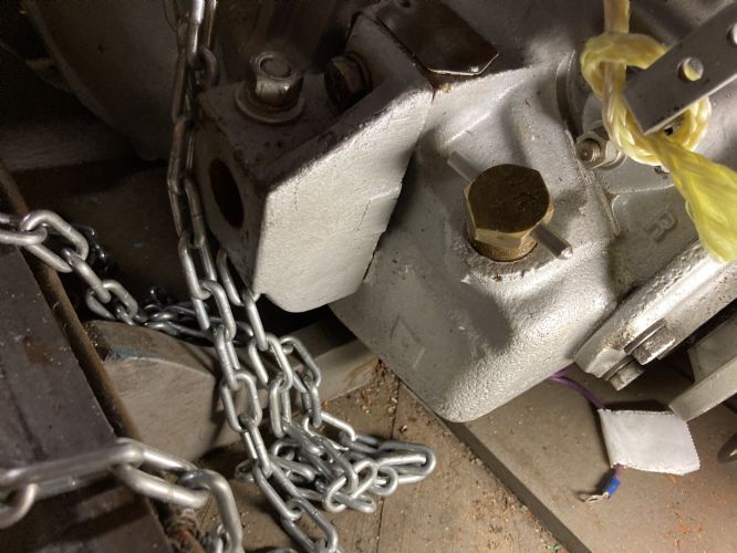

stepper459 View Drop Down
Joined: June-17-2007
Points: 349
Post Options Post Options   Thanks (0) Thanks(0)   Quote stepper459 Quote  Post ReplyReply Direct Link To This Post Posted: September-27-2021 at 10:20pm
Originally posted by ArtCozier ArtCozier wrote:
Originally posted by LongLakeWI LongLakeWI wrote:
Thanks Art!  Do you have a link you can send me to find your dipstick?
Haha!  The only kind of "link" I would know how to deal with would be those that make up a chain.  Right now I don't have any of them made up, but when I make another batch of them I could send you a photo or post a photo here. (If I can figure out how to do it)  My brain is too old to understand any of this digital stuff.
I think this is a picture of what he's talking about right here. This engine was in Art's hands pretty recently. I'll write more in another thread, so as not to hijack this one.
