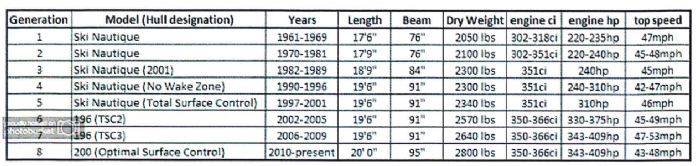

This chart has helped me out many times over the years.  Not sure where I acquired it.......most likely from the site.
SRB

Post Options Post Options   Thanks (0) Thanks(0)   Quote jimrogers74 Quote  Post ReplyReply Direct Link To This Post Posted: September-20-2021 at 7:40pm
fair enough.
the cool thing is the foam in the belly is bone dry....I just had stringers /floor / paint done last winter, and working on motor rebuild now. even had the trailer restored.
guys, this boat is going to be stunningly beautiful! I can't wait until I get it on the water---presumably next summer.
appreciate the replies. I'm afraid w/ a dude or two in it I might be taxing this lift.
