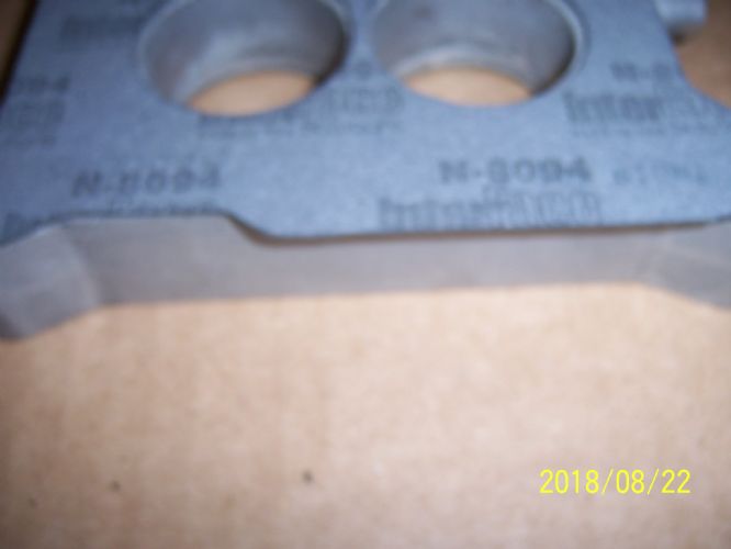

This is the spacer with an aftermarket gasket- you can see where the hugh vacuum leak would be

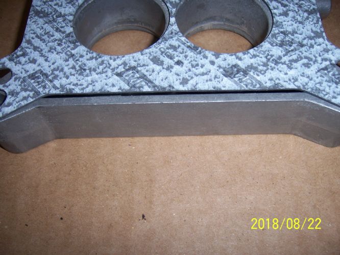

This is with the PCM gasket- |

Thank you Gary! Extremely helpful with those pics.

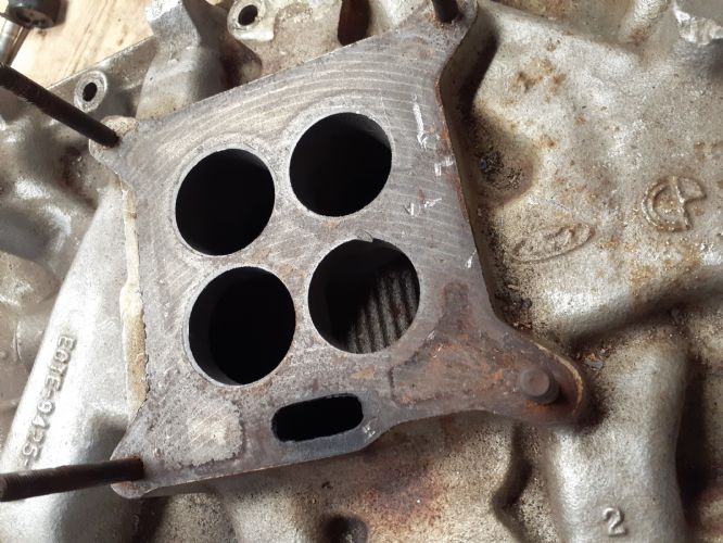

And here's the manifold (a kinda dirty ugly one) that the steel spacer goes on with the kickout and hole that Zach mentioned. The earlier intake didn't have the oval hole or the kickout and is shaped just like the spacer |
