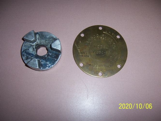

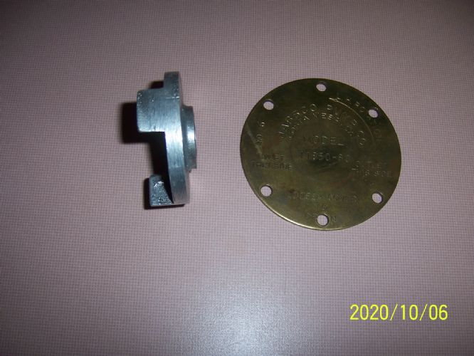

Hey I remember that guy- he bailed my butt out too. Lets see how this plays out,I would be willing to send the old one for a model. A few covers would be helpful as well.... Steve do you need a new drive dog too?
Gary S ![]() Grand Poobah ![]() ![]() Joined: November-30-2006 Location: Illinois Status: Offline Points: 14056 |
The only things that were good when I went through my pump was the main housing body and the cam. The shaft and cover I was able to get but the aluminum drive dog was a Holman Moody supplied part. It's wobbling ruined the shaft and the drive dog in addition to the ruined bearing/seal area. I was able to buy a Lovejoy coupler and have it machined locally.

Is your drive dog like in my last picture any good or do you need one of them as well? I'm willing to send my parts to Duane but you will have to work out the details with him. It would be a couple of weeks before I can get them to him but living in Indiana you aren't boating soon any way ;)
