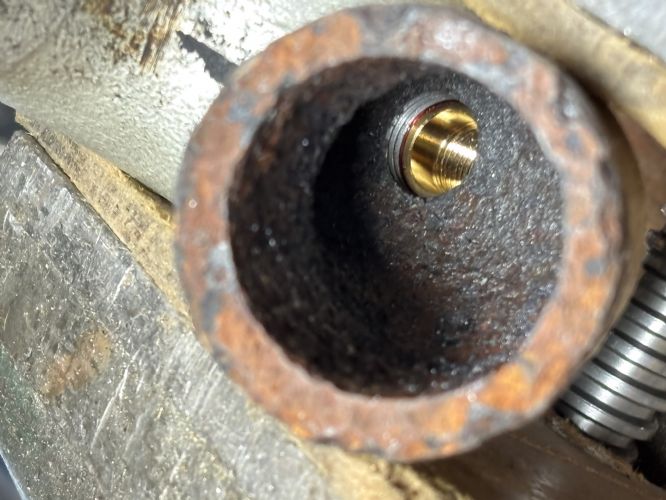

Here is an update to what I just did to renew the threads in the elbow by the sea pump and water pump on the 351W engine. The threads on this got really bad about 5 years ago. Ordered a replacement off of Nautiqueparts.com. Two hose clamps and out with the old and in with the new.
I am a big proponent of keep it original as long as you can...
So, I had the elbow in my stash of spare parts out in the shop. Wanted to see if I could make it work before I try to repair the threads in the block which are also severely deteriorated.
Here's the procedure I used:

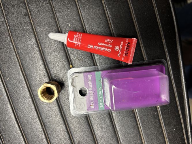

Purchased a 9/16" drill bit, a 3/8" pipe tap, a 3/8" x 1/2" brass adapter, a 1/4" plug, and some red Loctite.

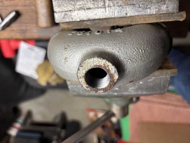

I clamped the elbow between two pieces of scrap 2x4 to level up the existing and offending hole for the drill press. I clamped the 2x4 blocks to the table of the drill press once I was happy with where the drill bit was positioned over the hole in the elbow.
Drilled the hole. Tapped the 3/8" pipe tap into the elbow. Cleaned off all the thread cutting oil with BrakeKleen. (My favorite shop chemical!!)

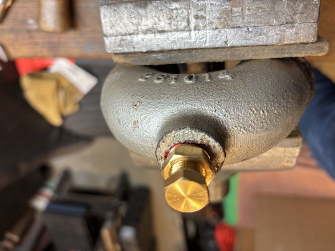

I was then able to check the fit of the 3/8" x 1/2" brass adapter. Perfect. A little Loctite and a few twists of the 11/16' wrench and we had new threads in the elbow!!!
Attached are some pictures of the progress along the way...
Hopefully, this will help my fellow Ski Nautique enthusiasts!!!
Brian
1985 Ski Nautique
"I've spent half of my money on women, liquor, and boats. The other half I wasted."

Nice.  Good fix.  Brass on brass will serve you well.
