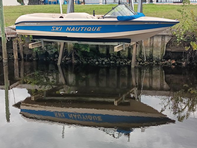

Thanks for all the help guys! I'll report back once the actual work begins. obligatory pic....Those with a keen eye will notice what I was working on....
Current: 1997 Nautique
Previous: 1987 Nautique 1964 American Skier |
TRBenj ![]() Grand Poobah ![]() ![]() Joined: June-29-2005 Location: NWCT Status: Offline Points: 21213 |
Is that a pseudo masters scheme (neutral, zephyr) with the light blue main stripe? Or is that photo tricking my eyes?
wetskier2000 ![]() Senior Member ![]() Joined: September-07-2005 Location: New Hampshire Status: Offline Points: 375 |
I guess it is. I had to go look for a Master's since I only recalled the green color. But yeah, we picked the light tan (Neutral?) and darker tan (zephyr?) and the light blue. But it was 28 years ago, I didn't remember the color names.
