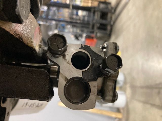

Just one more question
I also removed the oil sump filter from the engine. A friend of mine told me to backwash it to get rid of any slush. Although I didn't have any slush, I did remove it. There is a small diamond shaped gasket, does anyone have number or link for that? Or are these just universal? thanks

The gasket you are requesting info normally comes in gasket kits for rebuild. Being where you are might be a stretch to locate as a singular gasket. i think if it was me i would make a gasket from locally sourced material. also it is a dry application gasket. Cheers.. |

The oil pump suction strainer gasket you need is Felpro 72607, it costs a few bucks. It's too bad that there's nobody who could put the 2 seals and the gasket in a shipping envelope and send it to you in Belgium. One shipping fee and 3 reasonably priced quality parts I think I might know someone ![]() Send me a PM with your address over there and I think it could happen We'll just call it one "hobbyist" helping another one. Ps......I noticed that the Ebay rear main seal got sold, but there are other places with the same RR seal for under 30 bucks. Edit.....the Ebay seal is still there |

Hi Keno How kind of you to arrange something for me, I didn't see it untill just now. I actually got the small oil strainer gasket at a USA car shop for 10 euro. (dannycars Houthalen voor de belgen onder ons) The rear main seal I bought from Ebay from the link you got me. And the other seal (CR 18562) I got from Imes Dexis which is also a Belgium company for 18 euro. But thanks anyway Keno, always appreciate the help from all of the ''Grand-Poobahs'' of this amazing forum! I will also put in some photo's and so it might help someone else in the future.
