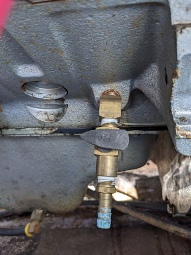

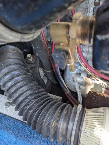

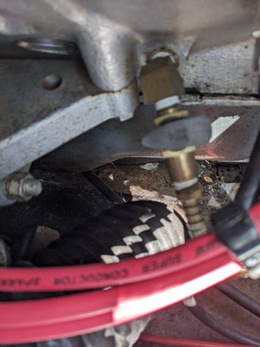

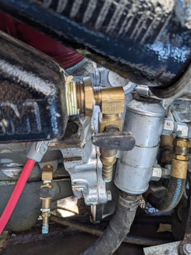

For those that have done it, can I see a pic of your setup? Thanks, Mark
Post Options Post Options   Thanks (0) Thanks(0)   Quote Jonny Quest Quote  Post ReplyReply Direct Link To This Post Posted: October-07-2024 at 4:34pm
Mark:
On my 2 previouis boats with the 5.8 Small Block Ford, I used these:
I purchased them from McMaster-Carr:
https://www.mcmaster.com/products/petcocks/drainage-valves-5/
I had one for each side of the block and one for the U-Bend (J-Bend) in the raw water system.  I also replaced the cast iron plugs with brass plugs at the ends of the exhaust manifolds/risers.

I purchased a set of drains from SkiDim several years ago. One for each exhaust manifold, one for each side of the engine block, and one for the U under the thermostat. They have worked well.
