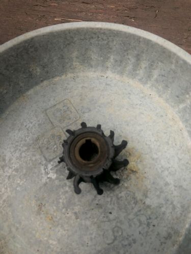

Took off the pump today and the impeller is mostly gone. So I know to check hoses. Remove main pump? Engine inspection? I’m at the cottage on phone and can’t figure sending pics yet. I’m
Post Options Post Options   Thanks (0) Thanks(0)   Quote fanofccfan Quote  Post ReplyReply Direct Link To This Post Posted: July-10-2024 at 3:21pm
Start by replacing the impeller.  Then look downstream of the raw water pump for chunks of old impeller.  Or do like most and hope they went on through.
Main pump....if you mean the circulating pump, nobody really checks that. If chunks got in there, they then make their way into the engine cooling passages, then you'd have to tear the engine apart and look in all the cooling passages
Engine inspection.....mentioned above, you'd be tearing it apart.
Look at the 90 degree inlets to both exhaust manifolds. Unscrew them and make sure there's nothing lodged in the fittings or in the manifolds.
And the suction side of the pump can also have pieces there, unlikely as it might seem.
So kinda like fanofccfan said, slap in the new impeller after a few checks for pieces and give it a shot

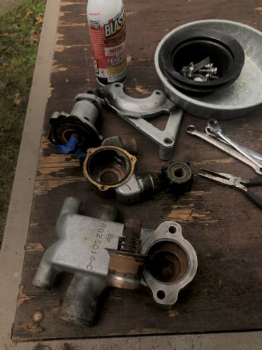

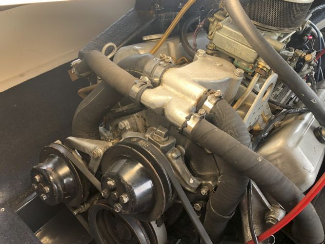

Here is the bad news, I removed and flushed all hoses, Ran water thru the main pump, Have not foun much impeller parts. Awaiting impeller.

Forgot the most important pic.
Post Options Post Options   Thanks (0) Thanks(0)   Quote KENO Quote  Post ReplyReply Direct Link To This Post Posted: July-13-2024 at 7:16pm
Well no wonder it overheated, it's a hawt lookin' Supreme Wink ..........except for the bag of manure that photobombed it's way into your picture
I see it has the big, old, expensive thermostat.
Did you remove the elbows at the front of the manifolds to get a look at the elbows and the entrance to the manifolds
About all you can do now is put things back together and take it for a spin and keep an eye on temperature.
And  make sure the suction and discharge hoses are on the right pump connections, otherwise it won't pump any water and you'll destroy your new impeller.
You'll most likely be just fine.
Post Options Post Options   Thanks (0) Thanks(0)   Quote MrMcD Quote  Post ReplyReply Direct Link To This Post Posted: July-13-2024 at 9:36pm
Those pieces are in your cooling system somewhere.
I would pull the exhaust cooling hoses like Ken Mentioned and search for more pieces, you can look into the exhaust cooling inlet with the hose off and blow water back through the hoses. towards the pump while they are off.   If water does not want to flow freely you might run a long wire through to help purge your pieces of impeller.  You are apart now, just a little more time and you will know it is clean where you inspected.  You should be back up and running soon.  If your new impeller is correct and fits order a spare now and keep it in the boat.   I have not needed my spare yet but have shared it with other boaters a couple times while out on a lake somewhere.
