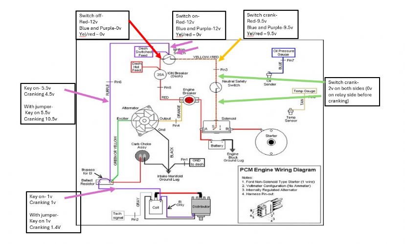

Post Options Post Options   Thanks (0) Thanks(0)   Quote jmesser Quote  Post ReplyReply Direct Link To This Post Posted: July-21-2024 at 8:23pm
Brainstorming here-
-I think I ruled out the switch as a problem (please see my diagram on voltages and let me know if I am wrong)
- Per a prior post suggestion, I did put a jump wire from batt pos to the coil pos while cranking to see if it would run, no change.
-My brain is fried form thinking on this. Please let me know if the voltages I noted are concerning or normal.
I am leaning toward the electronic conversion module being bad. I have the Pertronix 1581-82.
If I decide to order a new one, would it be better to order the 91581LS per this link? I think I am reading the 91581LS would be a better option than replacing the one I have with the same. https://www.correctcraftfan.com/forum/forum_posts.asp?TID=50237&KW=points+conversion&PID=601329&title=1999-carb-240-hp-no-spark#601329)
I believe I read somewhere the red module is protected from leaving the key on whereas the black one is not.
Johnnie Messer
Post Options Post Options   Thanks (0) Thanks(0)   Quote KENO Quote  Post ReplyReply Direct Link To This Post Posted: July-22-2024 at 8:14am
If you're getting a new module, the one you mention (91581LS) is a good choice.
No magnet ring to install, it's cheaper and it's protected from frying itself if the key id left in the Run position accidentally.
