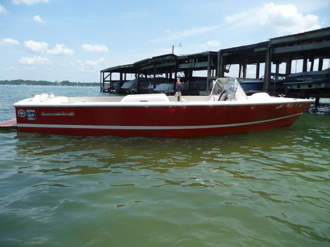

Can we see some pics of the boat. One owner original is always welcomed for pics...especially on a work day.

Not sure how to post picture, If someone could give me the Cliff Notes instructions I will sure do it!!!

Very nice!

Thank You! I noted another post in general discussion where owners are comparing their hull numbers; mine is SN2041. So, probably not a ground breaker but one of only a few around central NC anyway that is still going strong prior to large lettering along the length of the hull, Only regret is that it does not have the Holman Moody; the first Nautique on White Lake NC owned by the Johnson family from Dunn NC had one and the sound is unmistakably better with the cast aluminum exhaust manifolds!
