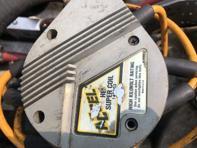

Post Options Post Options   Thanks (0) Thanks(0)   Quote GottaSki Quote  Post ReplyReply Direct Link To This Post Posted: July-20-2023 at 8:41am
If the impedance of the coil was lower then the ignition module can handle, then the module will overheat, and fail entirely or during use.
there is no recovery after that, it will be unreliable.
See if the module is switching, can be as simple as a test light.
Getting a new, matched , module and coil might be in order
Accel Super Coil, # 140003 is half ohm.  unless the module is smart and current limited, its too much current for it.  likely fried the module

The existing ignition module is older(?) GM # 990-5L11.  I found the exact Accel 140003 w/matching cap & rotor on Speedway Motors.  They also offer an Accel ignition module as "what others order along with the 410003"  I would like to assume it would work with the above.  But...is there a difference for marine applications?  They do not mention that on their site.  I'll call with questions before I order, but they're in the business of selling stuff.  Guess that's why I'm here.

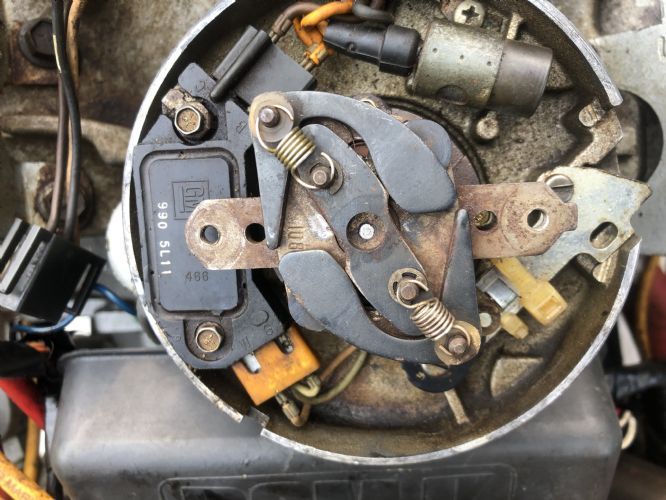

Post Options Post Options   Thanks (0) Thanks(0)   Quote JamoJones Quote  Post ReplyReply Direct Link To This Post Posted: July-20-2023 at 11:00am
Thanks Keno,
No vacuum advance, the parts are zip tied together.  The mechanical advance works, but is sticky, the springs don't return it vary well...just needs a cleaning I believe.   I'll try to post a pic.

Post Options Post Options   Thanks (0) Thanks(0)   Quote KENO Quote  Post ReplyReply Direct Link To This Post Posted: July-20-2023 at 12:53pm
Looks pretty automotive (AKA non marine) to me.
No vent screens ............... and .a pretty we'll just say "not too good job" of getting rid of the vacuum advance and blocking off the hole where it used to go through.
It may work just fine after you fix the no spark issue, but it leaves you more vulnerable to an explosion in the case of a gas leak meeting the spark in the distributor
They meet under the cap then you have the big bang that could be avoided with a marine distributor Wink
In the marine version, there's a little pop that has it's energy dissipated by the brass vent screen(s)
Same principle as an old coal miner's lantern
