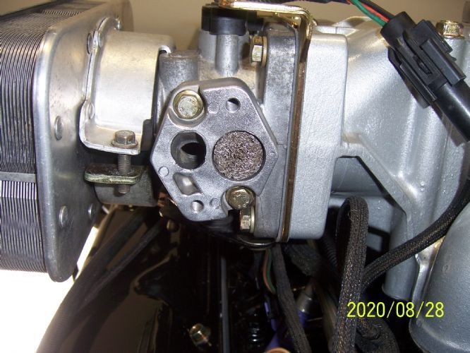

I'd start here,this is the air bypass valve removed, this screen can be removed and cleaned,check the valve to make sure it's not clogged

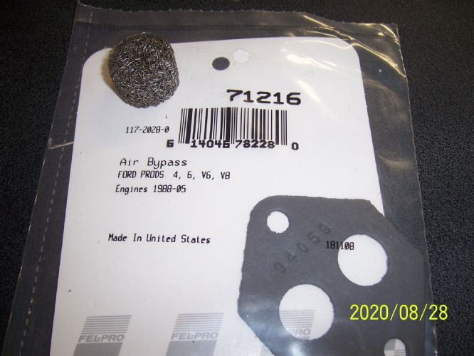

Here is a pic of the screen removed and a gasket you might need- Oreillys auto parts can get them for sure, others probably as well
