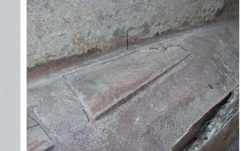

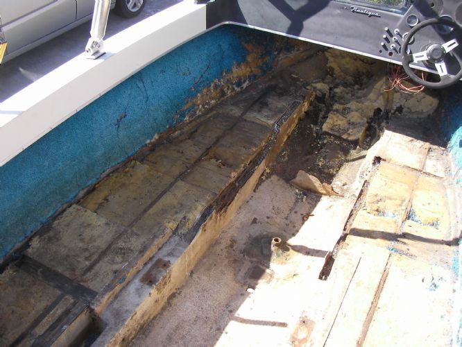

![]() ![]() ![]() They likely did find nails when the boat was cut open, the stringer system was pre built with 1 piece stringers and the crossmembers/bracing nailed in/on to the stringers before placing the assembly in a hull prior to being glassed in. The first picture (A-D) is from a brochure in the reference section , pic A, shows a stringer system being constructed. pic D, shows it being glassed in. The second picture is from my boat, the main engine stringers in front of the engine where the pylon and seat crossmembers/bracing are located was the worst part of the floor and stringers. The last picture and it can be seen in the second picture where glass wasn't laid because of pic A and pic D. The crossmembers were simply in the way of the guy on the right rolling on the resin, so glass just wasn't placed there, It's outlined in magic marker. Most likely, the construction and lamination process seen in the brochure pic was used when they began building fiberglass hulls all the way thru and up until they started using the fiberglass stringer system in 1993. The stringers were 1 piece as built and the shop who performs the repairs for you should install 1 piece stringers individually with the cross members cut in and glassed individually as well (with fiberglass between each piece of wood) to stop or at least significantly slow water intrusion from going board to board, that is my opinion of how wooden stringers should be rebuilt but that kind of work takes time and gets expensive. |
wayoutthere ![]() Gold Member ![]() Joined: February-28-2020 Location: Headquarters Status: Offline Points: 528 |
![]() You can see the crossmember location in the foam forward of the ski pylon.
