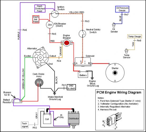

The AMN 0002 will need a jumper wire between the "s" terminal and the output terminal and then it can be wired like in the mid 80's diagram below.
They'll all do away with your external voltage regulator on your 76

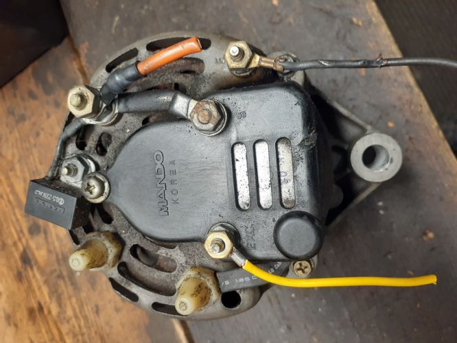

The picture below shows where the jumper would go on the Mando style alternator.
It's the strap between the "s" and output terminal with the black sleeve over it, but a 10 gauge wire works just fine.

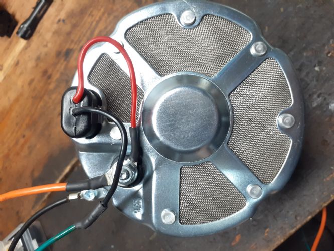

Hooking up a 3 wire Delco (with 4 wires counting the ground)
Same Black ground wire hookup and Orange output wire hookup
The Red wire is the sensing wire for the internal regulator and in your situation hooking it to the output terminal works well.
The black wire next to it that's hooked to the green wire is the 12 volt excitation for the alternator. The Green wire color is just because that's what I pulled out of the drawer Wink

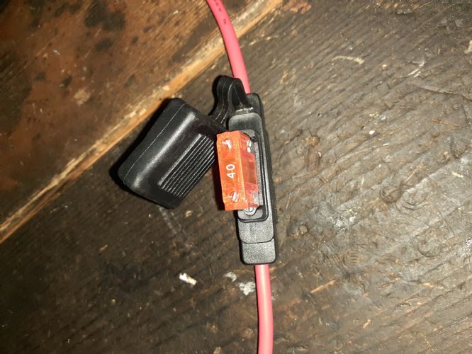

And.......since any of these alternators are a lot more powerful than your original the easiest way to protect your boat wiring which won't really handle much more than the original alternator's 37 or 40 or so amps is to put a 40 amp fuse right at the alternator output.
You won't use all the amps the alternator can put out if you get a 100 amp alternator, you're basically limiting it to 40 amps.
Some people just slap on a 100 or more amp alternator with no fuse at the output and can under the right circumstances melt wiring, make all kinda' sparks under the engine box and that's never a good thing
Here's a picture of a fuse setup that would work. The wiring to the fuse should be at least as big as the 10 gauge alternator output wire.
