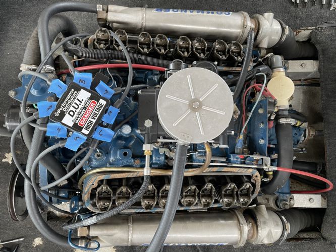

That would do it for sure!   A shop was paid to do this work?   I know some shops are very good and do magic repairs but the number of hacks out there taking money amazes me.
When you go to fix your fire order on the plug wires remember this is a FORD, Ford engines are 1234 on bank one and 567 and 8 on bank 2.
If you look straight down on your engine above your distributor and engine pulleys you will see one cylinder head is about 1” forward of the other at the front of the engine.   This forward head is always bank 1 where your #1 cylinder is on a V8 engine to get started.
Post Options Post Options   Thanks (0) Thanks(0)   Quote KENO Quote  Post ReplyReply Direct Link To This Post Posted: September-20-2022 at 6:55am
I imagine we should let him verify what he has for a firing order before getting too excited, but if 3 and 5 are reversed, they'd both be firing on the exhaust stroke since they're opposite from each other in the firing order.
Just swap the wires around, they'll fire when they're supposed to, and see what happens.
The picture from real early in the thread, before the distributor issue seems right on the wire arrangement
Edit..............verify that what you have labeled as #1 really goes to #1spark plug before changing anything around, a little voice in my head says that wire might go to #2 spark plug and the wiring is right
Or in other words that paper should say #2 not #1

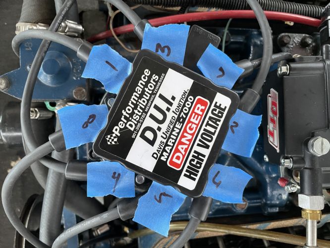

I was able verify some things this am. Just for clarification, the previous photo with the piece of paper with the marking #1 on the wire was where #1 used to be before going to the last shop. That is in fact where the #2 wire is and should be located now as KENO stated. See the below photos.
Ok, when I removed the plugs I marked every wire with the correct cylinder location (based on the photo provided earlier in confirming the firing order). So, I went back out and turned the motor to TDC with the dampener at TDC as well as the rotor pointing to #1 wire in photo below. I then marked all of the wires on the distributor starting with #1 and working my way around CCW. Then checked that the markings at the distributor matched the markings at the plug end. 1 to1, 8 to 8 and so on. They all matched. I have looked at these wires so many times in dealing with this boat that I could be going cross-eyed though. If anyone sees anything in the photo that does not appear correct please let me know. Thanks everyone.
Post Options Post Options   Thanks (0) Thanks(0)   Quote KENO Quote  Post ReplyReply Direct Link To This Post Posted: September-20-2022 at 12:17pm
It looks A OK to me Wink

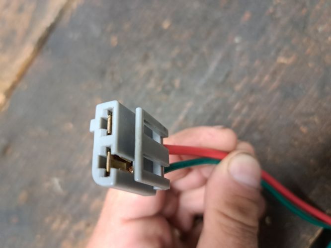

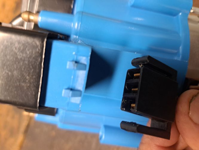

Here are a couple pictures of the plugs on your distributor.
The first one with 3 contacts is power to the ignition module under the cap and the coil on top of the cap.
The second one is the plug for power to the distributor and the tach connection. Like you said, you have a clip just like the second one connecting your power (you can see it in the first picture you posted in this thread) It looks like you have 2 individual plugs instead of one with 2 connectors but they accomplish the same thing.
Moving the cap around (like taking it off) can disturb that 3 connector plug. Some people unplug it and others just pull the cap and never pay any attention to that connector to verify that it's plugged in tightly and clipped.
I'd be checking the condition of all those terminals since a bad connection at any of them is never a good thing Wink
You could check the connections to the ignition module while the cap is off too
If the 2 connector power plug is bad/questionable a replacement pigtail with that plug is cheap

The first photo that KENO posted (the one with 3 contacts) is the one that is loose. It easily slides up and down and is only being held on by a very small amount of friction and if not for the plastic retention clips would likely slide off. Is there a way to carefully expand the contacts to snug up the fit or is a replacement connector the only option? Thanks for the photos as well KENO, extremely helpful.

After inspecting the three pins in the connector, the pin attached to the red wire was loose in the connector. The tab on the back of the pin was bent pointing up (not down as it should be) allowing the pin to slide in the connector. So when you would slide the connector together, the red wire would push back/out some. I removed the pin to the red wire from the connector, bent the tab back so it would catch correctly in the connector and re-connected everything.
Thinking the problem was now fixed, I started the boat and.......NOPE. It is now back to the it starts, idles poorly and dies off idle. Uhhhhhh.....
Since these connections are the only thing I have touched since in ran amazing last night, the gremlin must be in this area somewhere. I double checked all the connections again and no luck. I'll spend some more time on it later and keep you all posted. Thanks again.
