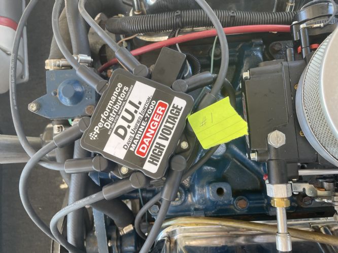

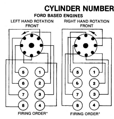

In pondering over the engine this am (but not starting it) the firing order appears to be different now after it came back from the shop. It is now 2-7-3-1-8-4-5-6. The distributor also appears to be rotated more clockwise than it was before. I am very confused as to why.
I am beginning to second guess myself so I apologize if I ask questions I should already know the answer to. Can someone confirm for me the correct firing order and also where I have marked #1 in the photo as the #1 wire position/location? Thanks again.
Post Options Post Options   Thanks (0) Thanks(0)   Quote 63 Skier Quote  Post ReplyReply Direct Link To This Post Posted: September-17-2022 at 1:56pm
I'm going to let someone else confirm the firing order so I don't mess anything up ... but if the gear dropped, was re-installed and distributor reinstalled at a noticeably different location, and the firing order is different than before ... there's a lot that can be going wrong timing-wise without the timing chain being the culprit.

Post Options Post Options   Thanks (1) Thanks(1)   Quote uncle-buck Quote  Post ReplyReply Direct Link To This Post Posted: September-17-2022 at 2:09pm
The correct firing order for a right hand rotation Ford 351W engine is: 1-8-4-5-6-2-7-3.
Is that the engine you have?
You wrote, "the firing order appears to be different now after it came back from the shop. It is now 2-7-3-1-8-4-5-6."
That is precisely the same (and correct) firing order, assuming you have a RH 351W engine. It is merely expressed in a different way.
You want to make sure you know where top dead center on cylinder no. 1 is and make sure it is the compression stroke (and not the exhaust stroke). When you are certain cylinder no. 1 is at TDC, observe where the distributor rotor is pointing. That's where the spark plug wire for cylinder no. 1 should be. Moving counterclockwise, the wire for no. 8 should be one position over. Then no. 4 and so on.
The spark plug wire you marked in the photo as cylinder no. 1 may be correct, *but* not necessarily. It depends on how the DUI was installed. The installer may not have installed it with the rotor pointing at its former location. Which could explain why the rotation of the distributor now looks different. As long as the rotor is pointing to the no. 1 wire when cyl no. 1 is at TDC, and the order of the other wires is correct, you should be good.
And I would still check for a loose timing chain without taking the timing chain cover off.

Thanks fellas! I really appreciate it. I will check TDC at #1 again and make sure it looks correct and verify the firing order. If so, then I will move on to Uncle Buck's advice on checking the timing chain without removing the timing cover. It may take me a few days to get to the timing chain check done but I will let you guys know what I find. Thanks again.

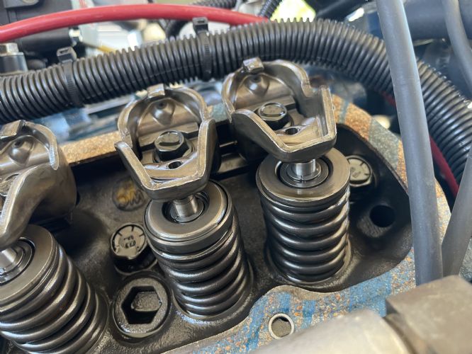

I removed the valve covers and checked the #1 valves at TDC on the compression stroke and both valves were in fact closed as you can see below. In rotating the engine CCW I observed the exhaust valve open then close, the intake valve open then close and both remained closed at TDC. Not sure what the shop was looking at but they are both closed at TDC. Thank you for the guidance on helping me confirm this for myself.
I then checked the remaining cylinders and watched the valves open and close. I'm not sure that I did it correctly for TDC for each cylinder but all of the valves opened and closed the same as #1. All the valves appear functioning the same and damage free. All of the valves looked identical to the #1 valves in the photo below. I did not find any loose springs, they were all tight with no play at all, even when closed.
Anything else I should check while everything is apart? Thanks everyone.

Post Options Post Options   Thanks (0) Thanks(0)   Quote uncle-buck Quote  Post ReplyReply Direct Link To This Post Posted: September-18-2022 at 12:53pm
MourningWood's solution of a hardened roll pin on the distributor gear sounds good.
Seems like the engine should now start and run.
Are you getting a good 12 volts to the DUI?

Post Options Post Options   Thanks (0) Thanks(0)   Quote KENO Quote  Post ReplyReply Direct Link To This Post Posted: September-19-2022 at 8:28pm
Originally posted by AZ86SKI AZ86SKI wrote:
Looking at your picture above with the #1 plug wire marked by the piece of paper and working my way around the cap counterclockwise, i can't come up with what looks like the right firing order based on which 4 wires are going to one side of the engine and which 4 go to the other side.
It might have something to do with the hallucinogenic mushroom pizza I had for supper, then again maybe the order just ain't right Wink
Those mushrooms are still affecting me but it sorta looks like #3 and #5 plug wires are swapped
That might make your engine a V6 or maybe V5 1/2 with the low compression on #7.
uncle-buck View Drop Down
Joined: June-14-2004
Points: 337
Post Options Post Options   Thanks (0) Thanks(0)   Quote uncle-buck Quote  Post ReplyReply Direct Link To This Post Posted: September-19-2022 at 8:40pm
Good catch, Ken!
