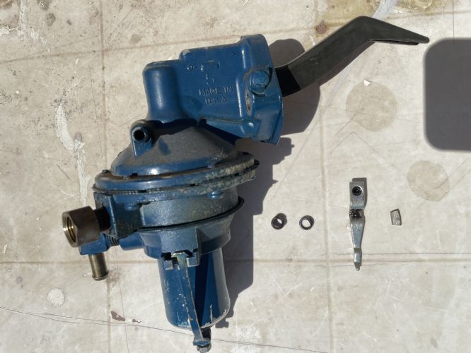

PROBLEM FOUND! I call this post "Interesting Fuel Pump Finds". Big smile
In anticipation of receiving the new fuel pump I went ahead and removed the old fuel pump. When pulling out the pump what also followed where a number of pieces as you can see below.
The first two pieces next to the fuel pump are parts of the spring which are obviously broken. After close inspection, it appears that these two pieces have been broken for quite sometime and not just recently. I am assuming that the third piece is part of the pump assembly that would have ridden on the spring.
Now, the fourth piece (far right) does not appear to have anything to do with the fuel pump and I think I know where it may have come from. When I removed the original distributor way back before beginning this post (before installing DUI distributor) I noticed that one of the teeth on the distributor gear was chipped. This looks like a perfect puzzle piece fit for that old chip. Could be wrong but it sure looks like it.
I have just a couple quick questions. Would a fuel pump with a broken spring even pump (because apparently this one did at least a bit)? Also, it appears that when installing the new pump that the pump lever rests under the cam that can be seen through the port for the fuel pump, is that correct? It doesn't ride under a lifter/rod like in a Chevrolet, or am I not seeing the lifter/rod? Do I need to grease the new pump lever at all or will the engine oil take care of that? I know my technical terms may be off but hopefully I'm close enough to make sense.
The new fuel pump has arrived so I should be able to get it installed soon and report back. Hopefully after now finding something physically wrong/broken a final solution has been found. Although at this point I will believe it when I see it on the water under load and not requiring a tow.LOL
Thank you again for everyone's help, I really appreciate it.

Piece 3 falls out when the spring breaks, and there's another internal spring that keeps the pump somewhat working.
If you want to exert maximum effort putting the pump in, then rotate the engine CCW with Jonny's big wrench so #1 is at TDC on the compression stroke, but if you want to make it easier, rotate the engine one full turn after that and #1 will then be at TDC on it's exhaust stroke and the eccentric exerts the least amount of force on the pump arm so installation is easier. Like you said, the arm goes under the eccentric.
And............. it's nothing like the Chevy pushrod setup

Looks like you found a real problem.  Hope it finally gets your boat purring again.

Nice work AZ86SKI. It’s gonna sound great blasting past 2700 rpm. Turns out she was thirsty.

I am curious how the bad fuel pump worked well in the bucket fill test but would not function under load on the water.   Maybe the fuel demand was higher under load?   As I recall he had good pressure and it flowed well when initially tested?   Just curious so we respond better to the next poor soul that bumps into a fuel starve question.
Post Options Post Options   Thanks (0) Thanks(0)   Quote 63 Skier Quote  Post ReplyReply Direct Link To This Post Posted: August-19-2022 at 2:28pm
Agree Mark, thought we'd ruled out the pump and line to the tank by checking fuel pressure/volume.  I wonder if it's just a case of how that broken spring aligned each time it was turned over, sometimes it was in a position to do some work, sometimes not.

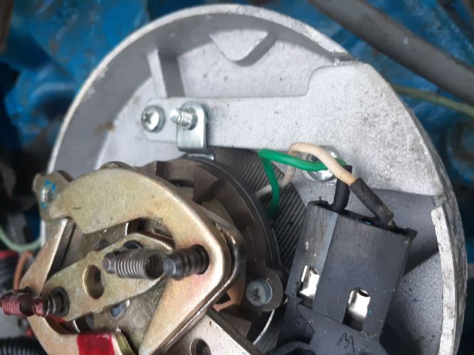

And the mystery continues....
I was able to physically check that when the #1 cylinder is at TDC, the marker is also pointing at TDC on the harmonic balancer. Not sure why the light was showing different. It's not the most expensive light.
I also physically inspected the new DUI distributor and the rotor was pointing to #1. The rotor and cap appear free from any cracks/defects and the advance mechanism moved freely.
I also checked the breaker at the rear of the engine and it has not been tripped.
In discussing with the GF about when it died on the water. When I heard a pop, which sounded like it came from the carb (but I could be wrong about where it came from), she says she also heard a metal clank. When it died, it just died. No sputters etc.
I am at a loss at this point. Any other thoughts?

Just a wild swing at potential issues.  When you set the float level was the engine sitting like it does when on the water?  I only ask because if your boat is sitting nose down on the trailer your float level will be way off.  You need to level the boat like it would sit going down the lake, so slightly nose high.   An eyeball check is close enough normally on the level.
For no start and a clank or pop when it died?   Not much to guess with.
When things don't work for me I go back to the basics.
Verify compression in all 8 cylinders.  Does not matter if you did this one week ago, something changed and you are trying to find what changed.  If you have good compression on all 8 you know your valves are opening and sealing as intended so that tells you the timing chain and cam are spinning as intended and rules out many other potential issues.
On your timing, if static timing, engine not running is set to #1 at TDC and your distributor rotor is pointing at #1 on the cap Timing is close enough to start the engine, spin the engine over with the dist cap off just to verify the rotor is spinning as it should.
If it starts now I would make sure the Timing light is connected to the #1 cylinder and set the initial timing to 8-10*.  Next with the timing light still connected engine running watch your timing marks as you raise the RPM slowly and see at what RPM the timing stops advancing.  As you rev and slow the engine speed the timing should advance and retard smoothly and exactly the same every single time in sync with RPM.  Full advance is usually somewhere between 2,800 and 4,000 RPM.  Keep raising the RPM till the timing stops advancing and is stable.  So if you think it quit advancing at 3,500 take it up to 4,000 just to make sure you are correct.  If you have a dial back timing light this will also let you know exactly how much timing the engine is getting at what RPM.  Normally you will see between 32 and 36* fully advanced.   You stated timing was  90* off, sounds like you may have grabbed another wire by mistake.  An 8 cylinder engine fires every 90* of rotation so being 90* off might just be wrong wire as a source and that wire would be right next to your #1 wire location so either the wire left or right of #1 on your cap.
If it is getting spark and your Spark is at the right time, It is getting Air, (the choke is wide open)  and has compression it should start right up.
When you find out which part is missing/no longer there, you know what to do next.

With fuel delivery visually confirmed, spark at each cylinder and the distributor functions checked and confirmed as well, I will be moving on to checking the compression at each cylinder again. The good news is I have the compression numbers when the DUI was installed  by the mechanic and well before it died on the lake. So I at least have a baseline of where they were.
So onto the compression check. The compression numbers were in the (140-150ish range) before it died and the boat only has 408 hours. I do not want to even consider internal failure at this point as far as we have come. Although, I have gone from a great running boat on the trailer to a boat that doesn't even start now. Perhaps we should start looking at the mechanic now (me). Ha. I guess the compression test on each cylinder will let us know something, but I hope not.
It may take me a bit to get the compression check done, but I will get it done and report back. Any other ideas until I get that done are greatly appreciated as well. Thanks everyone.

I forgot to mention that when I removed the old Carter fuel pump I inspected the fuel filter in the pump and it was very clean. I don't know if the fuel pump diaphragm is upstream or downstream of the filter but I wanted to mention for clarity if diaphragm failure was a possibility.

If you're looking for something that could change your timing by about 90 degrees, take a look at the pictures below.
It's a DUI Ford distributor and you can see the plate that locks the 8 legged pickup coil in position so it can't move. The pickup coil moves if you have vacuum advance like in an automotive distributor and the plate is one part of the "conversion" to a marine distributor.
If anything is broken so that the pickup can move, it has about 45 degrees of movement which just happens to correlate to 90 degrees of timing at the crankshaft
Probably a long, long shot but it's free and easy to check Wink
AZ86SKI View Drop Down
Joined: July-05-2022
Location: Phoenix, AZ
Points: 117
Post Options Post Options   Thanks (0) Thanks(0)   Quote AZ86SKI Quote  Post ReplyReply Direct Link To This Post Posted: August-24-2022 at 1:44pm
Hey KENO,
That is definitely something I can check and see if there is any movement. These are new part names for me so thank you for the photos. I will give that a check and report back when I get it done.
Your post got me thinking about checking the timing when trying to start it versus it running. When I checked the timing after it died while trying to start it, it was showing 90*. I then checked that TDC was correct as posted above and assumed we were good. My thoughts were that perhaps the timing light was off due to the balancer not spinning fast enough like when its running or just an inexpensive light. So my novice question is if I know my timing light is attached to number 1 plug wire with no cross talk with other wires and I check the timing trying to start it, will the timing light still be as accurate as if when it's running? Meaning should it actually show 12* instead of some other number like 90*? I hope my question makes sense. This was my first time checking timing while trying to start an engine so I have no experience what the numbers should show when it's actually NOT running. If it should show 12* when trying to start and we know that TDC is correct start then your suggestion makes a ton of sense whether its long shot or not.
